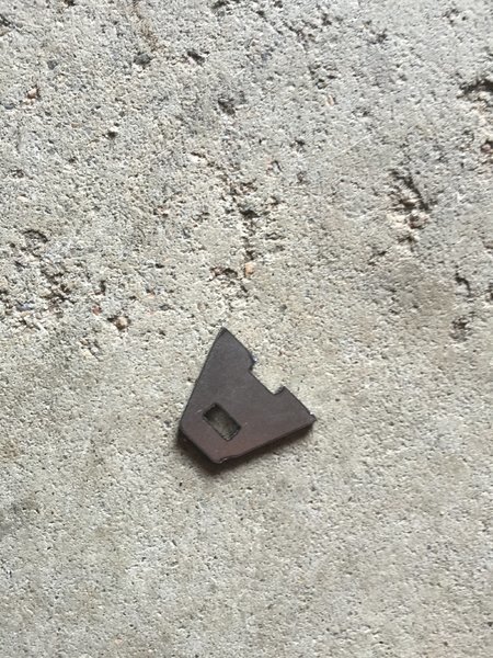

    I busted out a bunch of stuff over the past two weekends, ripped the entire front end apart:
    - New Rack Doctor rack
    - Whiteline rack bushings
    - TC cam tab gussets and crack repair
    - LCA rebuild with new uniballs, cleaned up the bushings and welded on new limit strap tabs
    - Cut the body up for clearance on the tophats for the engine crossover brace
    New rack feels SOOOO much better, steering is tight and effort less, have been this excited about basic maintenance in a while
