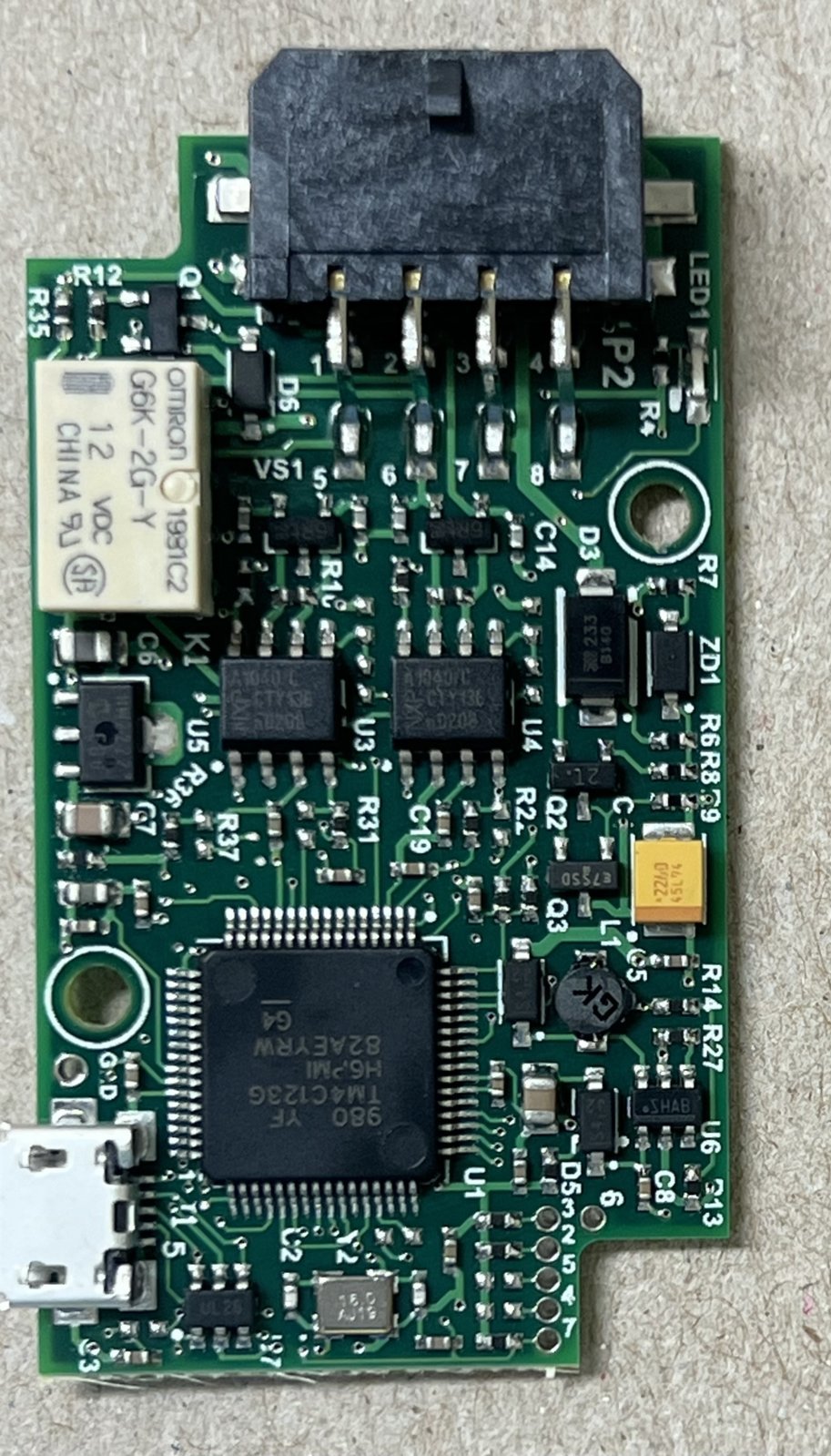

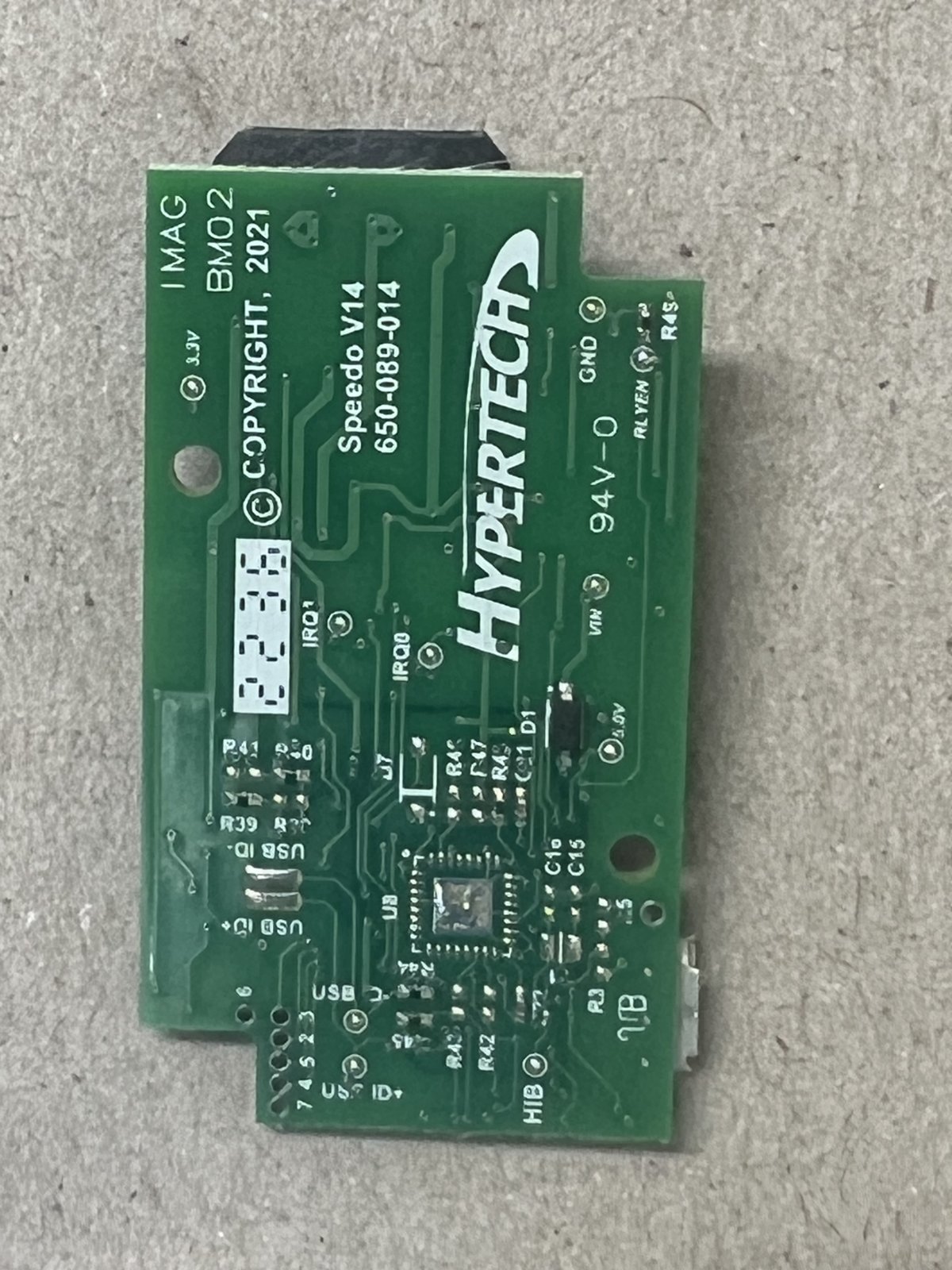

    I have the Rough Country version, and have used it for years. Same thing as the HyperTech and half the cost.

    They don't, it just a rebranded Hypertech unit.
    They don't. It looks like a rebranded Hypertech unit. Or they both get them from the same supplier.
    https://www.roughcountry.com/product/speedometer-calibrator-90043
