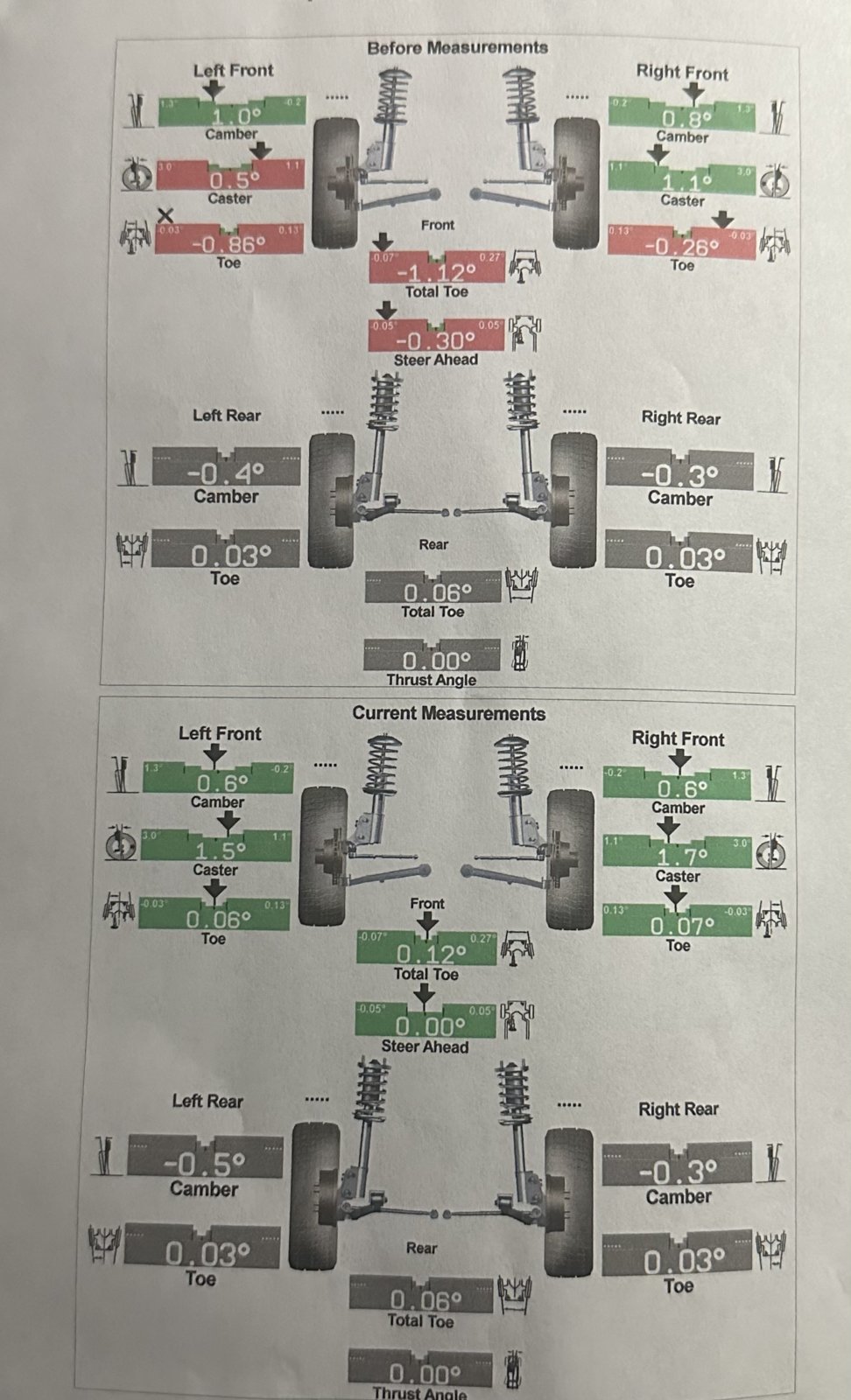

  3. Mar 28, 2024 at 6:19 PM
    MGM_TacoEnjoyer
    MGM_TacoEnjoyer [OP] Member
    Mar 16, 2024
    #445997
    14
    2020 Mgm sport dcsb
    To much
    Yea I did here is what I got
  4. Mar 28, 2024 at 6:32 PM
    TacoJoeBro
    TacoJoeBro Well-Known Member
    Jan 9, 2019
    #278690
    288
    Not Joe
    Midwest
    12 DCSB OffRoad
    6112/5160 Icon RXT JBA KO2
    Numbers look pretty good. I’d prefer a bit more caster, but it’s in spec. The rhythmic vibe that goes away in 4wd sounds like the needle bearing problem tacos are known for, but that’s on drivers side. Is the pulling right constant when in 4wd or just under throttle. My has a tendency to pull when in 4wd on the road, definitely more noticeable when there are grooves or ruts that the road gets from semi trucks.
