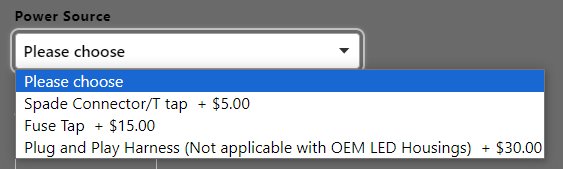

    It would be your responsibility to determine the inputs to these devices.
    My default LED T includes DRL, park and ground, then a diode module combining DRL and park to a single positive which is on anytime the stalk is not off. Then a pigtail to connect grille lights or whatever.

    OK, so, I see your order for one driver side LED T. That will work OK for the trim panels but you'll need a wire across the grille to get to the one on the other side.
    I assume you're "stuck" because they don't offer an OEM LED PnP harness. If you have the trim plates already or you want to wait until you receive them and take a photo of the connector they have (if any) that could help. You could also send to me and I can make it fully PnP if that's truly what you desire.
