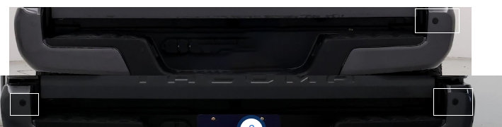

    @musicisevil - thank you. That is a good to know. Okay last question, both these trucks are 2021 (both accident free). Any reason why one has, I guess to cameras (?) in the back vs the one on the other? These may not even be cameras.....I personally don't know.
    Thanks again.

    Those are the backup sensors... should be two more lower on the bumper.

    @pMill
    It’s odd that the top picture only has a sensor on the passenger side…
    Like Bert said they are the parking sensors, and there should be 4 total. That truck in the top pic warrants a thorough inspection with a fine tooth comb. I’ll bet one of the bumper caps has been replaced.
    It’s hard to tell from that pic but it doesn’t look like it has the two sensors in the center. Care to share links or uncropped photos?

    59
    @musicisevil @Bertw192 - That is what concerned me. Since they are both the same year (2021) I would think the camera positioning would be similar. But one clearly is missing the one on the drivers side. Unfortunately, I will probably rule out that one since both have a fee to get them sent to our location. Thanks for the info.
