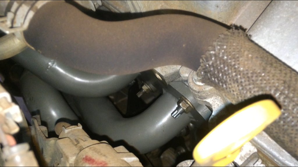

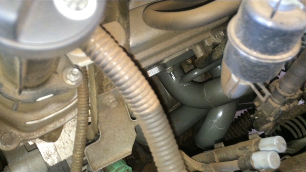

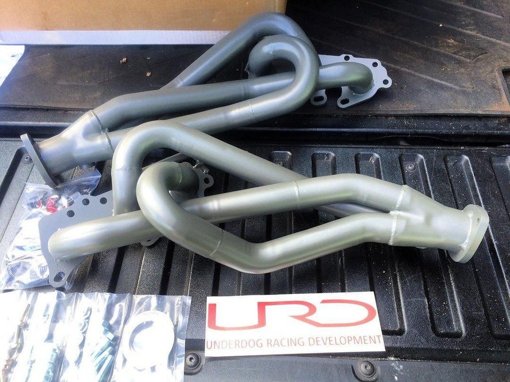

    2013 Tacoma. Install was a pain! No instructions. Transmission crossmember needed to be removed to remove the stock Y-pipe. Steering shaft needed to be separated to install the driver's side header. You need to be careful not to turn the steering wheel when the steering shaft is disconnected or you will damage the spiral cable. Air injection studs needed to be removed to remove stock exhaust manifold. You also need to remove the stock upper studs in the head and install shorter ones provided. Special external Torx sockets are needed. All the nuts for the headers were difficult to install because of the tangled tubes. Tightening them was even worse. Thorley long tubes are way easier to install. Don't want to install these ever again.

    Looks good bud! For the record, You don't have to remove the Trans Crossmember to pull the Y pipe. Just have to fully disconnect the Y pipe, and remove the guard that is on the crossmember. Its 2 bolts IIRC, one on the frame and one on the crossmember. Trust me, I spent a good 20 minutes trying to get that damn Y pipe out before I realized that crappy piece of metal was blocking it :D

    On this truck there was no way the Y-pipe would come out without removing the transmission crossmember. If there were instructions the job would have been less painful, haha.

    Do you have a double cab long bed? Im tryna figure out if spec u exhaust fits.

    This truck is a DC/LB. An extra section of tubing is included to make up the added distance required.
