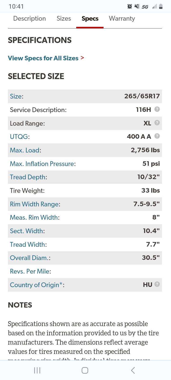

    Found a great deal on used raceline 17x9.5 wheels, can I run my 265x65x17 cooper AT3s on this wheel?

    According to Tire Rack a 265/65R17 fits a 7.5 to 9.5 width wheel.
    Trublu68[OP] likes this.
