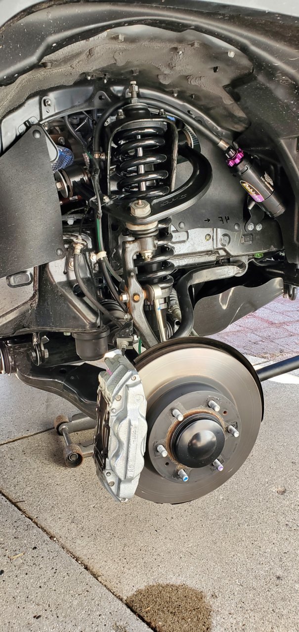

    Here is a what I ended up with for the front. I need to wrap something around the hose where it contacts the shock tower still.
    Also what gorilla tightened up the jam nut? Had to put the spanner wrench in a pipe to break it free. But once I got that looses adjusting ride height was pretty simple.

    It's a double lock nut on the struts. The lower comes off the top one pretty easily normally, then you set the height from the top.

    Yes, it took a pipe on the spanner just to loosen the bottom nut from the top nut. So my advice is to loosen the jam nut while off the vehicle. That would also have made it easier.
    Pro tip using some WD-40 on the threads and where the top nut contacts the lower spring retainer makes it easier to adust the nut.

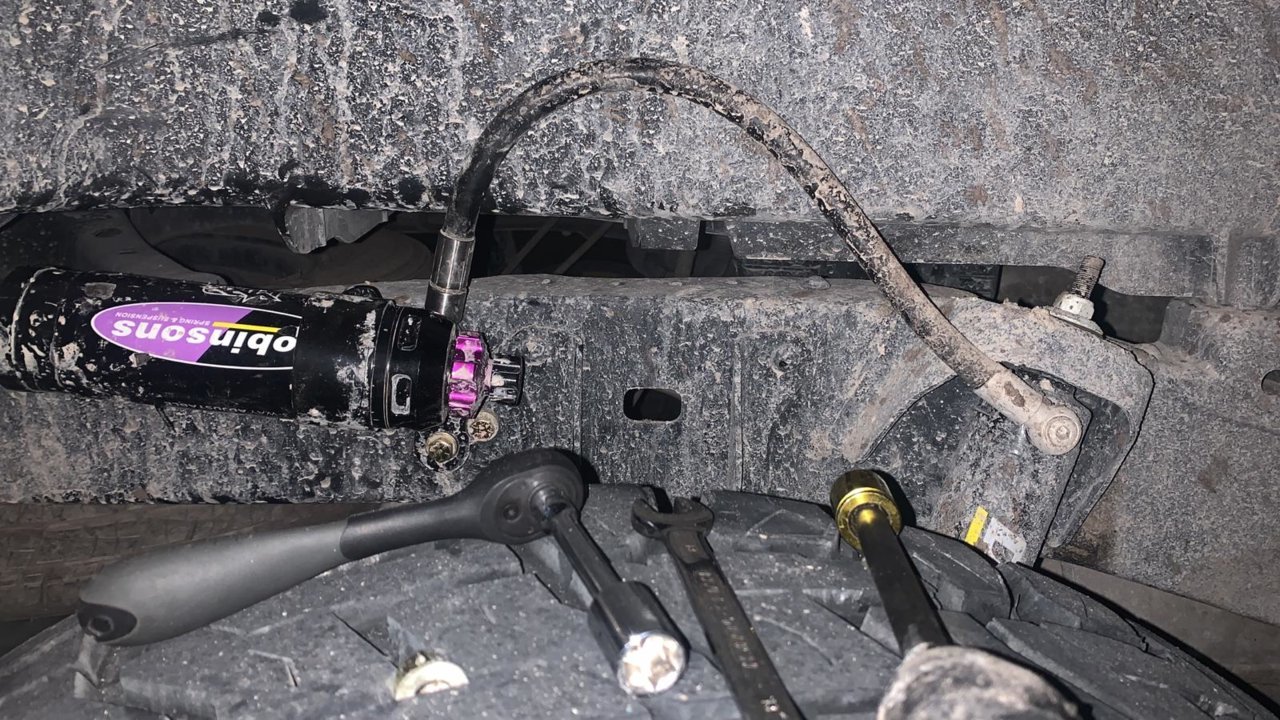

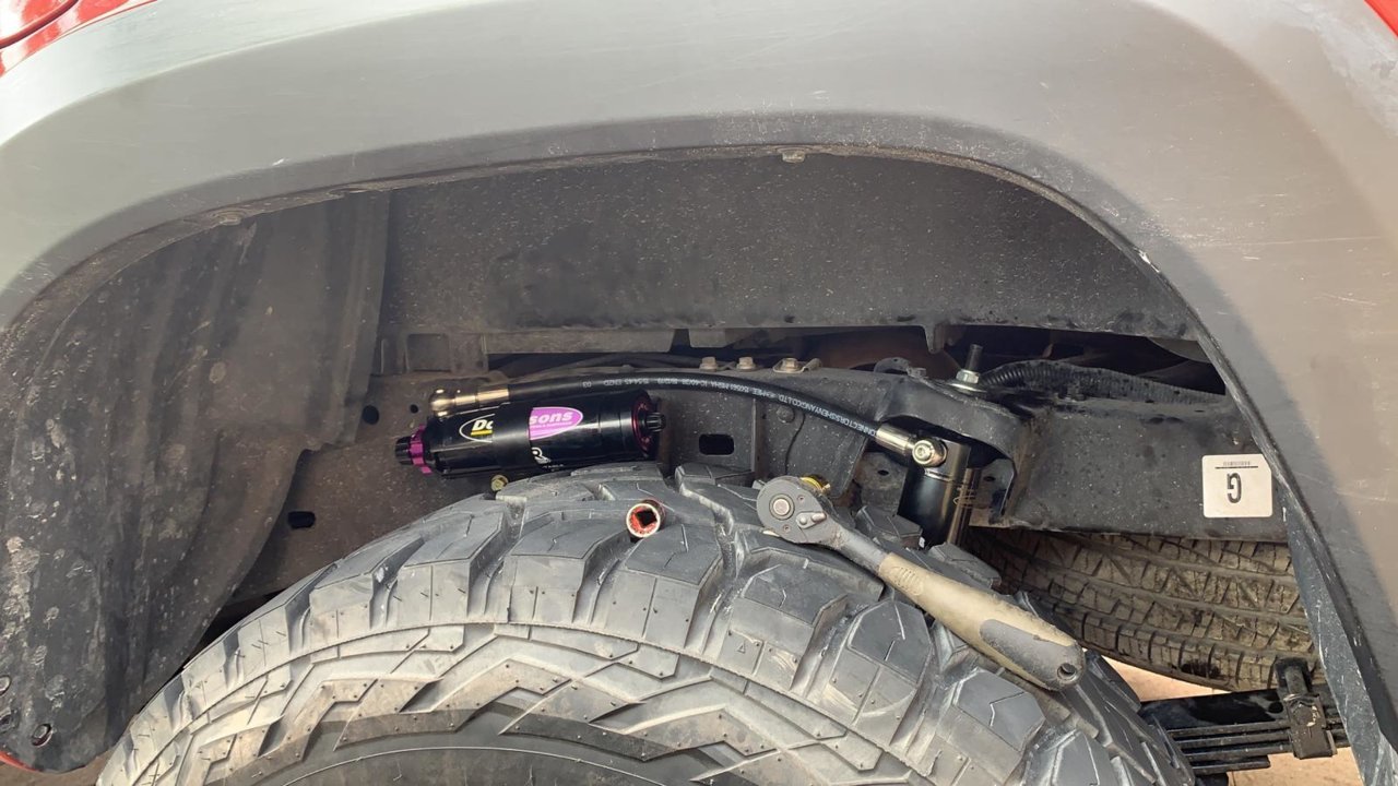

    I just got these photos from another Tacoma owner who mounted the rears recently.

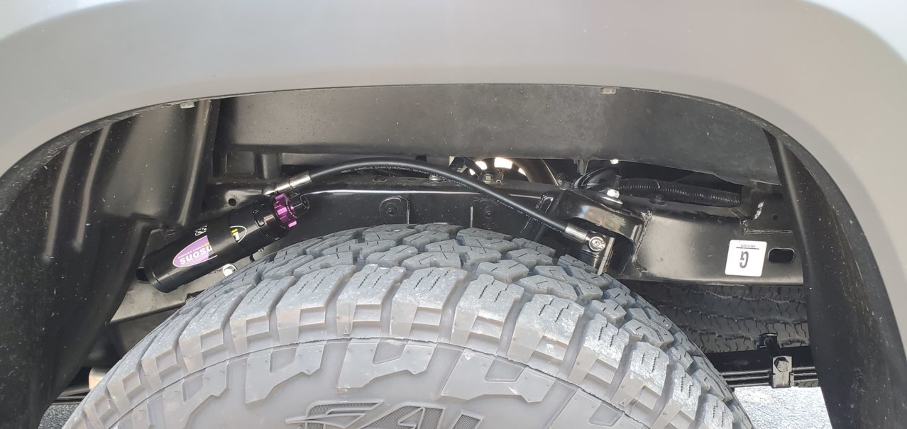

    My passenger rear and driver rear

    Great, it looks perfect!!
