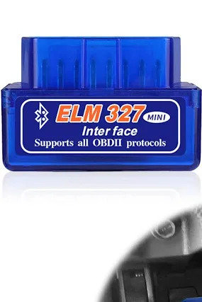

    Is that similar to my ELM327 obd2 reader,i have.?..ill bet theres a app w fuel guage- I know there is w temp an rpm an speed..

    2nd gens don't report fuel level on OBD so a scan tool won't help you watch it.
    An untragauge/scangauge calculates fuel usage and DTE pretty close if you "train" it right.
