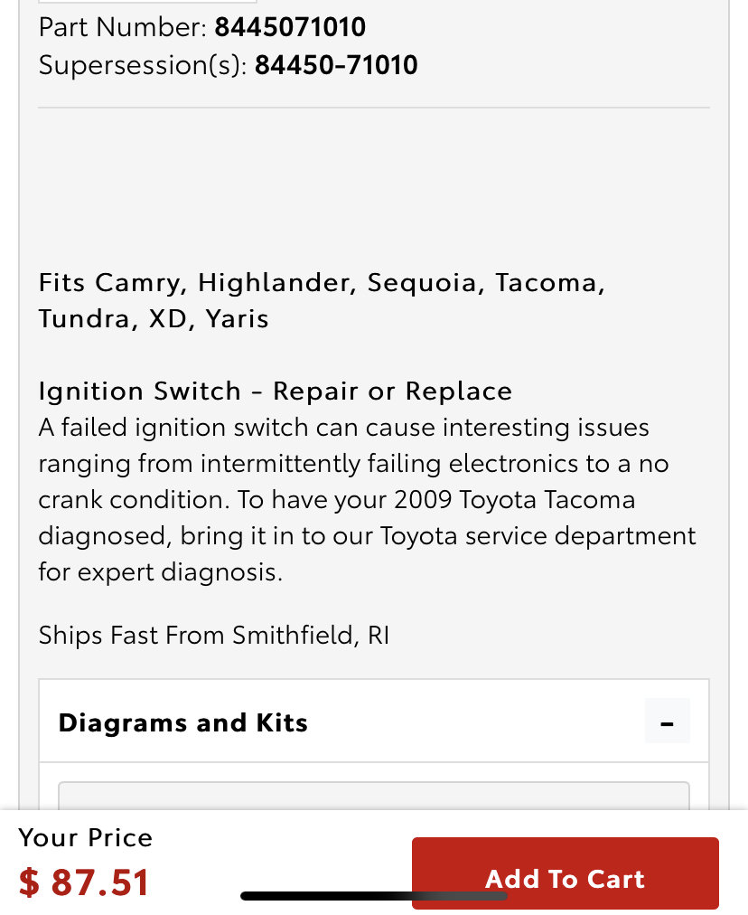

    Ah yea I missed the part about it stalling, I would be checking the ignition switch then.
    The immobilizer will not cause it to stall once running nor disable the starter so it's not that.

    Thank you for the info. The description for the ignition switch pretty much sums up my issue
