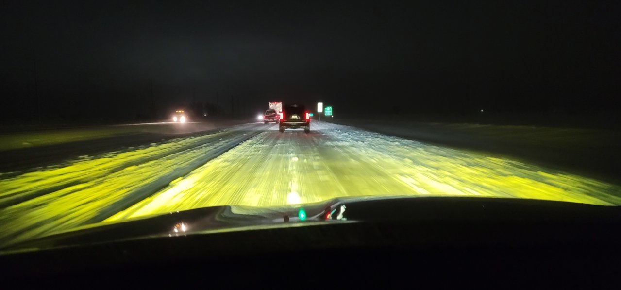

    Back to the Yellow fog light subject. Below is my buddies 2020 Subaru Legacy with OEM LED headlights going through a pretty good snow on the way to work. He has the Diode Dynamics SS3 Max Yellow. Not the greatest photo but you get the idea how much they help!

  18. Nov 19, 2021 at 7:03 AM

    Im going to have to go that route then thanks again!

    -Bilstein 6112 front shock. Leveling lift -Bilstein 5100 rear shock w/TSB leaf pack. -Cooper Rugged Trek 265/70/17 -EBC front ultimax rotors w/yellow pads -Stoptech sport rear drums -Steel braided brake lines -Wet Okele seat covers front/rear with heaters -Custom built exhaust with Black Widow venom 250 muffler -Afe Stage 2 Dry CAI -Diode dynamics SS3 fog lights yellow. -OPT7 Projector Headlight Assembly w/Black backing -Undercover Flex Tonneau cover -Weather Tech floormats front and back
    Diode dynamics ss3 sport yellow with Phillips Xtreme +130% headlight bulbs. I'm in CT and this combo works great for the weather we have gotten last 1.5 year that Ive had it.
    With and without fogs. These are only the sport level... the pro or max versions will be even more.
  20. Nov 19, 2021 at 8:27 AM
    #20
    Tacoma~Gal
    Tacoma~Gal Well-Known Member
    Nov 7, 2019
    #310075
    516
    '23 LR OR
    Thanks for the pics! I've been trying to decide on sport vs pro, based on your pictures I think I'll be more than happy with the sports.
