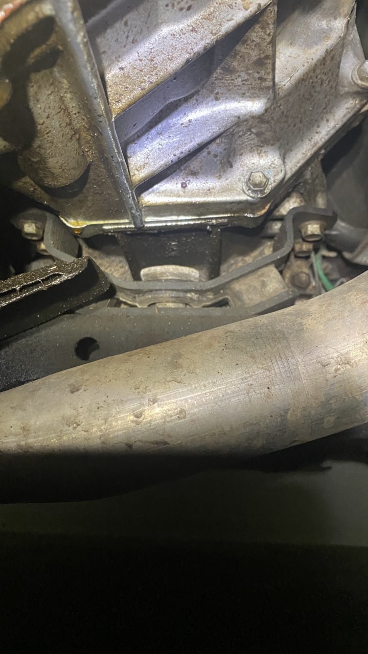

    DA20295E-57D1-43BD-9827-2B0252F60E8D.jpg Noticed a few yellow drops specifically coming from the black plate that covers the circled part. Any idea what it could be?

    That looks like oil
    How many miles on the truck?
    Leaking from transfer case maybe

    noticed it after oil change too. 40,951

    It’s a oil leak of some sort
    I would start at the rear of the motor with a flashlight ( rear main seal possibly) , oil pan gasket
    The problem is oil blows and spreads all over. If you can’t find the source clean really good and keep an eye out . The powertrain is still under warranty
    Be glad you all over it now

    Yellow sounds like new oil to me. Start looking for a leak

    The circled part is your transfer case, gear oil in good condition would be golden. Worth it to check the fluid level.
    but the best start would be cleaning it up and see what comes back.

    DEF urea?

    Check oil filter and plug first

    I would check the oil level and transfer case oil level and if ok you can drive it. It doesn’t look severe but to be on the safe side check them both.
    Then I would clean the areas and see where it is leaking . If you don’t want to do that take it to the dealer but at least double check the engine oil.

    Sloopy work at oil change place possibly..."residual iol" is what they call it ...basically oil that has dripped onto skid plate trickles down where ever ..just to mess with your mind ...

    If they added oil without draining oil it's possible it would try to find a way out

    Clean out area with brake cleaner and wipe, drive around and get underneath to check where oil leaks.
