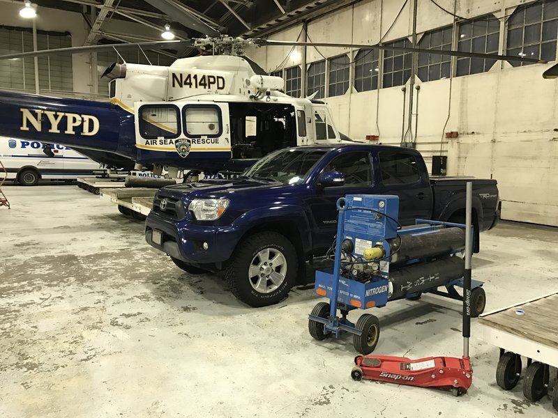

    I noticed afternthe last snow fall a yellow fluid leak a few inches forward and left of my Left Passenger Tire. I searched and found no visible stains underneath. Two days later I rotated my tires in the hangar at work and noticed a yellow leak on the floor after I pulled the truck outside. I cannot 100% confirm that this one came from my truck as the entire floor has oil and fluids from the aircraft. I spent 30 minutes looking at the suspected area with a flashlight and UV light and again no visible leaks or stains underneath. I'm posting a photo of the location in reference to the Rear Passenger Tire. I doubt it is the rear diff relief valve due to the location. I read a post about a chemical reaction that stains snow yellow which makes no sense at all. Any suggestions or help is appreciated. Thank you

    vtdog, it is in the rear below the muffler next to the tire. I am down to the exahust, shock oil, rear differential oil, or brake fluid. reg boulette I am sort of leaning towards the stainless but can't find too much if an explanation out there.
