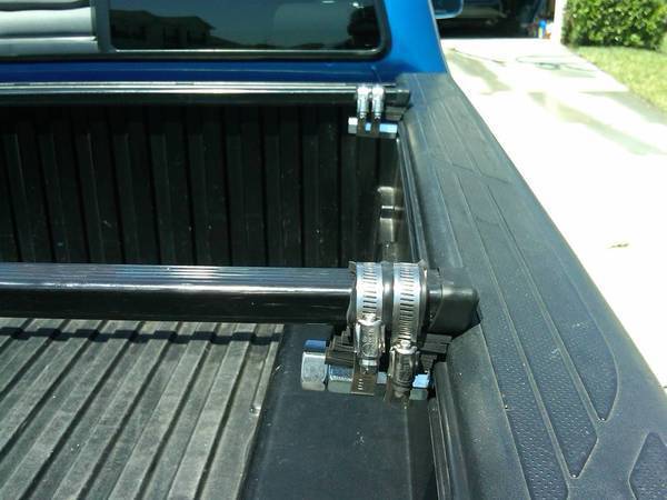

    I wanted to put some Thule bars across my bed to put bikes on it while keeping storage space under them. I already had a Thule rack for my car so went with the 58" bars incase I want to use the towers and these 58" bars on top of the truck.
    I liked the Toyota bars, but they were pricey as is the Inno Rack system, plus the 58" bars won't work.... Tried the U-bolt method with the tie downs, but wanted to keep those free for use as tie downs...
    I came up with using 5/8"x3" bolts with the hex washer with another nut to lock it all together. Then I stacked some dense rubber pads under the load bars, placed one pad on top, then used (2) hose clamps to hold it all together. It seems to work well, but think I will add a washer against the bed rails and maybe double up the bolt system in the back to stop it from twisting. I don't mind some twist since the bike carrier will stop the twisting, but I plan on placing the front tire holder on the rear bar which will apply a twisting motion. All in all this will be around $20 for the holding system.
