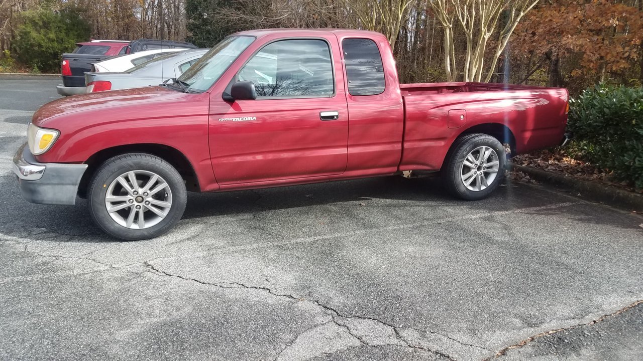

    Hyundai wheels, dings & dents...
    They look great, can't wait to see them on the truck!
    Any idea what the wheels weigh? I went from the stock 14" to 16" and the weight difference was enough that I notice it. It's not huge and not very drastic but acceleration is a tad slower. MPG dropped 1-3 also, depending on how much the skinny pedal is abused.
    EDIT: I think the total difference for each wheel and tire was about 9 lbs. I think it was around 32 lbs with the 14" and around 41 lbs with the 16". Might not be remembering the actual values correctly but should be close.

    Thanks for weighing! I read that too about how heavy the Xrunner wheels were and immediately ruled those out. My tires are still 215 wide so I probably saved a little weight there too although 245s would look pretty sweet.

    Thanks man! Tires are 215/60/16 so they're about a 1/3" taller than stock. Offset is 44 and I think they fit perfectly, nice and flush with no rubbing. I spent many months on that exact website you listed (wheel-size.com) searching through make/models to find wheels that had a centerbore of 67.1 because I didn't feel like messing with boring them out. Jeep, Hyundai, Kia, Mazda and Dodge are a few that are 67.1 and Buick and Ford had wheels that were actually larger than that. I also spent a lot of time on ebay looking through wheel pics to determine offset specs that I had a hard time matching up on that website. The one thing I could never really find reliably was weight specs on any of the wheels I was interested in. I never came across that rtwwheels.com site, that would have been helpful! Seems pretty accurate too, I think my wheels did weigh right around the 22lbs listed on the site.
    Man, I love the way your truck looked!

    @Babybluetaco Thanks for the extra pic, getting a couple more beauties in this thread is putting a smile on my face! I will be adding mine soon as them darn tires come in of course..
    @ireymon Those 215/60/16 tires on Sonata wheels really help fill the gap nicely! I wonder if the extra height may have added to the slightly more sluggish response you noted as well. I am hopeful the smaller diameter will compensate a bit for the added weight. Report to come soon..
