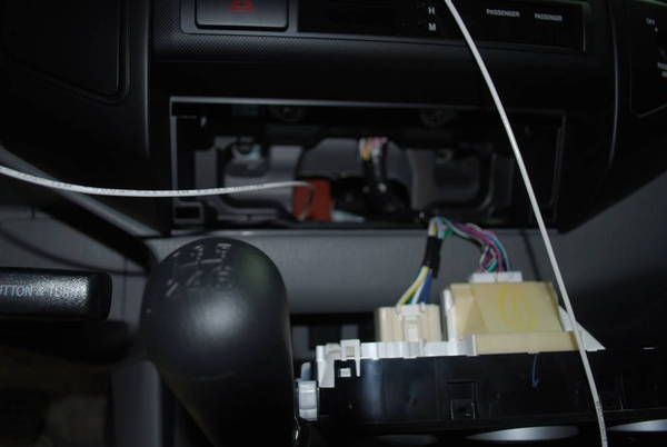

    Removed trim and identified antenna connection. This was very easy to do.

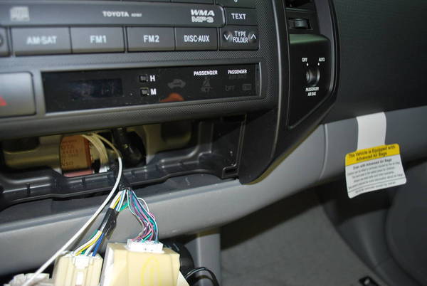

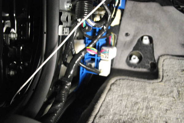

    Ran patch cable and hooked into the antenna lead.
    Fished cable behind dash and out control pod opening.

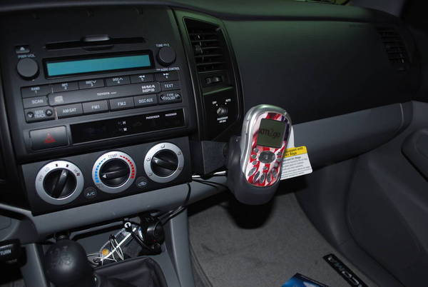

    Installed MyFi and tested it out.
    MyFi sticks out a little farther than I would like but overall I like it. It does not block the AC vent like it did in my Sonoma and I still have the flexibility to use the MyFi in the garage.
