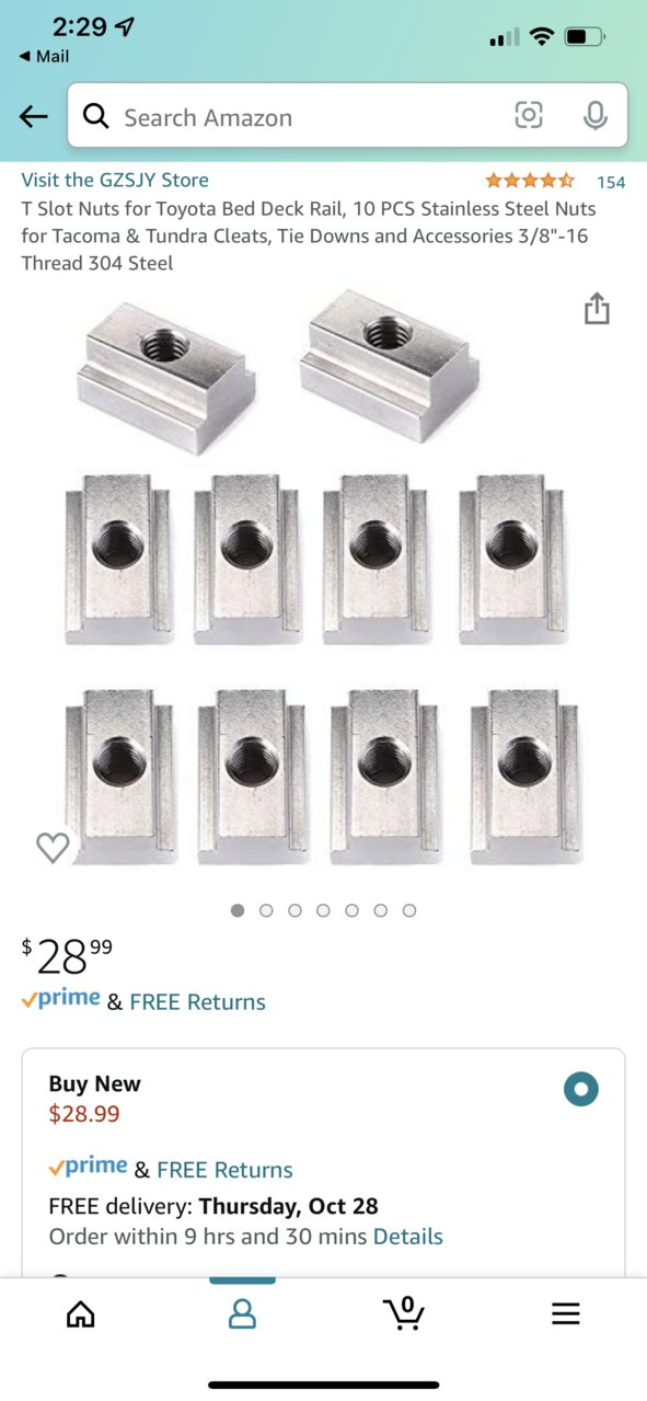

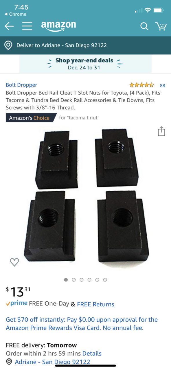

    here’s a quick pic I just snapped. Look up t Nutz and Tacoma bed rails on Amazon you will find them. Bring to hardware store and find appropriate eye bolt diameter. I don’t remember the size off hand. AFF93880-E7A4-4828-8DDA-F8186022A01E.jpg

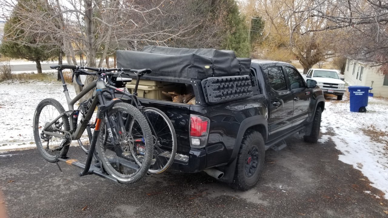

    Ive got the same boards. First I gotta say they are awesome! used them a few times and they work super well. anyway, I made some mounts for mine out of steel channel stock and some bolts. They hang under my RTT. I easily could have made them fit the bed rails.

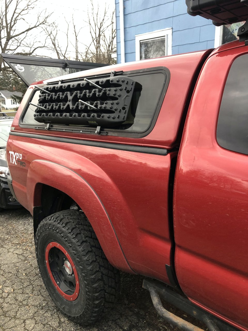

    I have the same set of boards. These are the best pics of how I have them mounted on my Prinsu rack. Just take 1/4” carriage bolts and mount them through the holes in the center, not the outer holes. Large fender washer and wing nut hold them down.

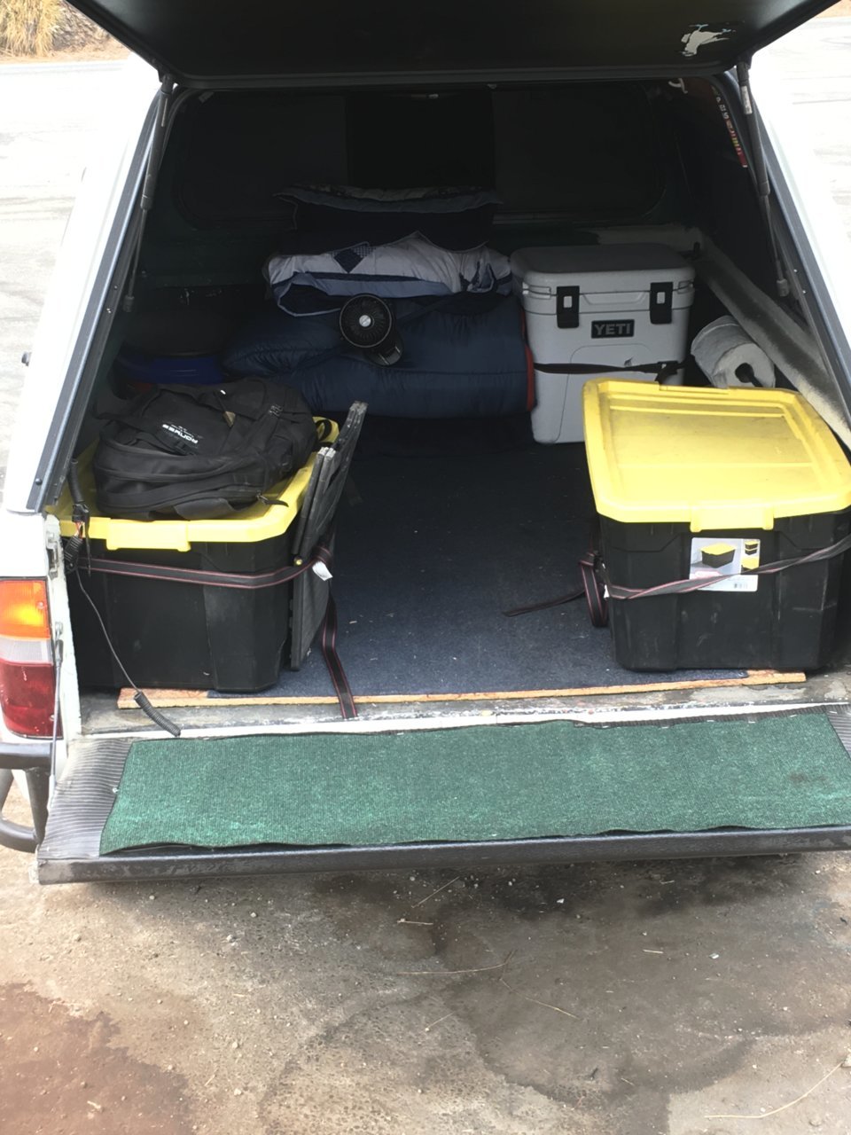

    I just three them in the back of my bed0074F580-C109-40C6-B037-7F3FDD2063F8.jpg

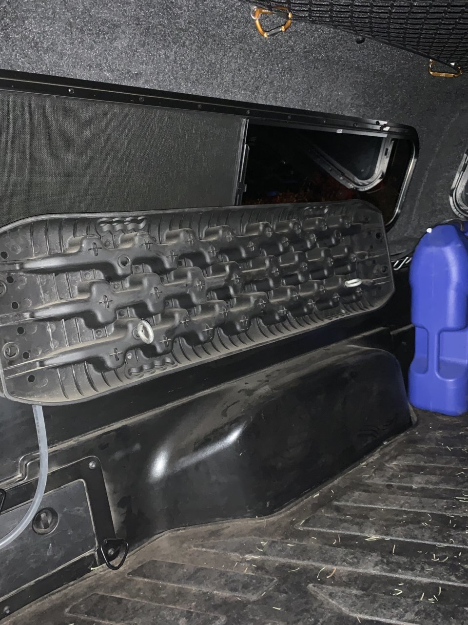

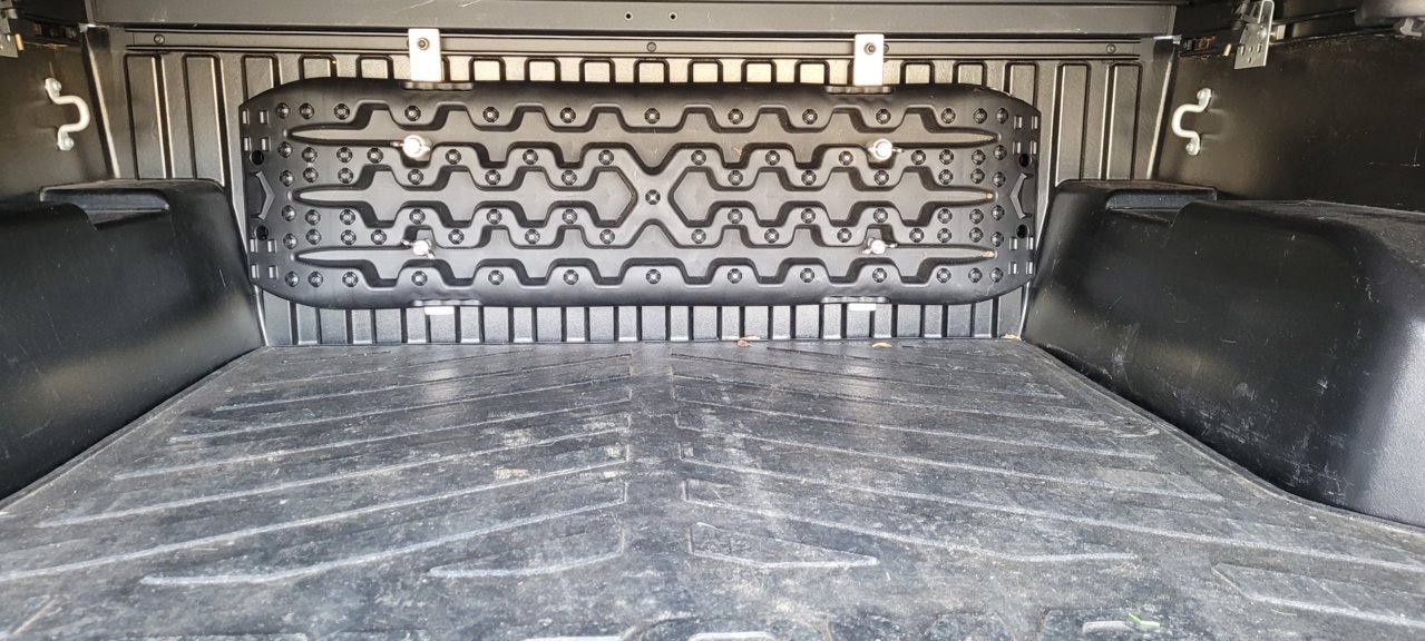

    I have two on the side of my KB Voodoo rack. I was lucky enough to find some threaded 1/2" bolts with threads down to the base. Used some washers and nuts to lock them into holes already on the rack (I would have drilled them if they weren't there). I only mounted the two bottom holes which works but could be better with all four. Only minimal movement, regardless. Had to go to ACE to get the nuts, but they're a join kind of nut that I use either my multi tool or 1/2" wrench to get on (wing nuts get stuck too easily and spacers are not an option seemingly). This also works as a sort of antitheft for any crook that doesn't have tools on them (not strong, I am aware). Either way, I love the look and they are really easy to get to when I have needed them. I can snag a better photo of the hardware if anyone is interested. 20201127_114633.jpg
