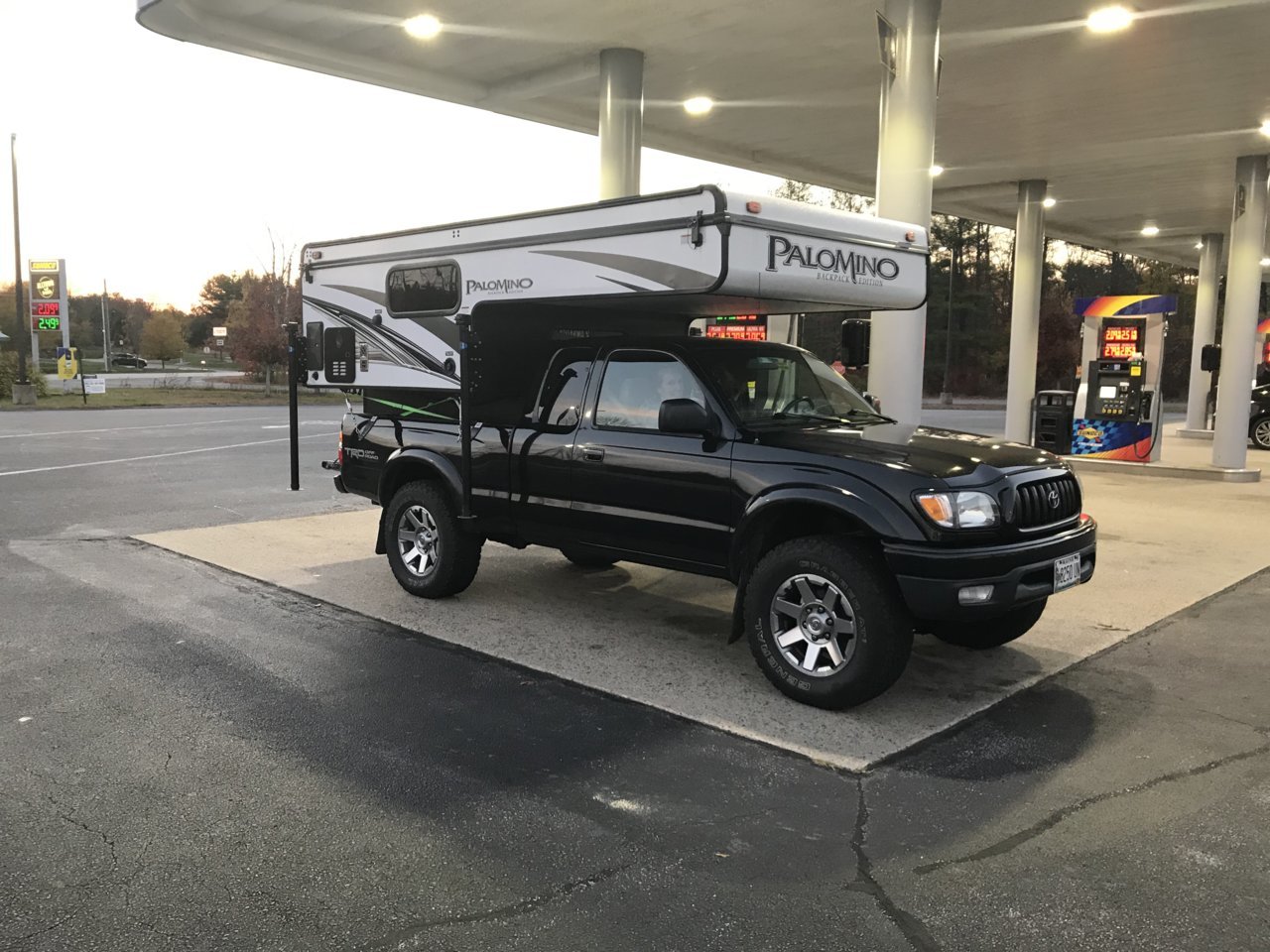

    I have researched this extensively. For us with short beds, I am convinced there are only 2 reasonable slide in camper options since you are putting more weight behind the axle. Long beds, you might be able to get away with other campers. What I have found is the palomino SS500 (the poor mans FWC), and the FWC are the best options. The palomino is actually a very nice rig for less, with all the amenities. It is the only affordable slide in out ther (if you don’t get a hybrid type shell camper) and was designed for midsize trucks so keep this in mind people. I believe it weighs 1197. Also, one thing people don’t talk much about is the center of gravity of the camper which plays a big part in your hauling comfort. I think it is something like 22” from the bed of the truck. I am in no way concerned about hauling this camper with my shortbed TRD. NOTE, what people don’t realize is even with upgraded rear leafs you really MUST add air bags. Since our trucks don’t have rear sway bars. You’re almost better off just adding bags and not worrying much about springs. They keep the truck flat and level when cornering. What’s good with bags is they are dynamic, you can adjust the psi to whatever your hauling! Hell, most people with half tons should really have bags too if they have a slide in! If I can do it with my Tacoma, a half ton can too, not sure what the haters are talking about, they obviously don’t have bags or never thought they needed them or don’t want to admit it.
    As far as pushing the payload, I know some people would rather have room to spare than be pushing or exceeding it. I guess I am more optimistic than most but I really don’t care that I’m pushing it if I have put real thought into what supporting mods I have on my truck to handle it. It does bring up a good question though, I am sure many people with over landing setups or even just a slide in are over “legal” sticker capacity for the truck. If a cop cared you could get in trouble. But like I said if you have the supporting mods and the truck isn’t turning heads because you’re on the bumpstops then no one will question it. Pics below are my friend’s 1st gen and the 3rd he bought the camper from. 1st gen didn’t have bags at the time of the gas station picture.7D82700A-FE61-4EA6-8000-D0174169F186.jpg8ACFA359-CBD0-4C1B-9F03-5DAD9766BD6A.jpg05E35208-3C9F-43AF-8026-4F1AB8B007A5.jpg

    According to the manufacturer, the SS 500 shipping weight is 1197lbs. That is overweight for any Tacoma, unless you are driving it from a chase vehicle by remote control ;-)
    That number obviously does not include water or any gear or (important) weight of the "overlanding" mods you might be dreaming about..
    Loaded up, the camper, supplies, people, and gear would be at least 50% over the listed capacity of the truck and its components, including transmission cooler, brakes, wheels, tires, suspension, engine/oil cooling and a host of other systems. Can it be done? Sure! Can it be done safely and legally? Nope.
    Sure, the camper will physically fit in the plastic bed of your truck, but I would be concerned with the puny brakes (and rear drums), and the weak engine and tranny. The terrible fuel mileage, small fuel tank and greatly reduced range might or might not be important.
    Get a F 150 Hybrid and roll with confidence, better power, more mileage and you have a built in 7.2kw generator when in the boonies. The F-150 hybrid can be configured to safely and legally carry over 2,000 lbs, almost 2x the capacity of the Taco (not surprising, full-size vs mid).
    Or, grab a 5.0 and get up to 3,300+ lbs of payload and a 2.0kw built in generator (with a 36 gallon fuel tank!). Your fuel mileage will be better than the Taco, you will have an extra 100 hp or so when needed, 4 wheel disc brakes, and a host of other improvements. The entire experience of hauling a camper in the bed might actually be tolerable, safe, and legal.

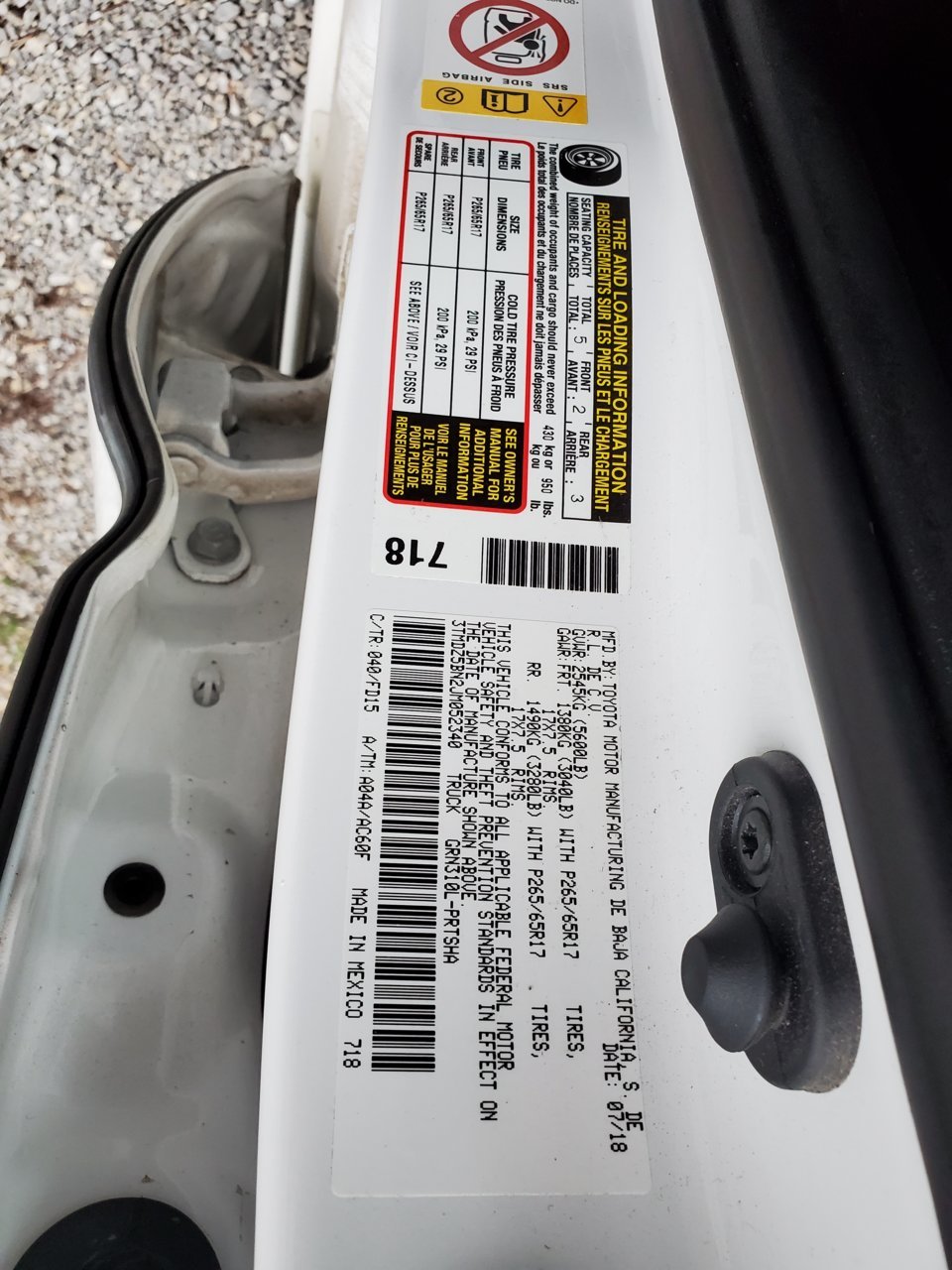

    The 950 lb is the cargo limit of your truck.
    If you have added any mods? These will alter the cargo limit. The scale of the impact will be the weight difference between what you remove and what you add.
    Example: Remove 100 lb bumper, add 150 lb bumper with winch mount + 80 lb winch, will mean your adjusted cargo is reduced by 130 lbs or a limit of 820 lbs.

    The white sticker that says GVWR is 5600 pounds. The truck with everything in it is supposed to weigh less than 5600 pounds.
    The 950 pounds of payload is including you, your family and everything in it. Essentially with 5 average adults, a Tacoma is rated to carry grocery. A SR model 4 cylinder 2wd extended cab is the way to go to get 1500 pounds of carry capacity. On the other hand, lots of guys here claim to have 6000 pound Tacomas with all their trail armor.
