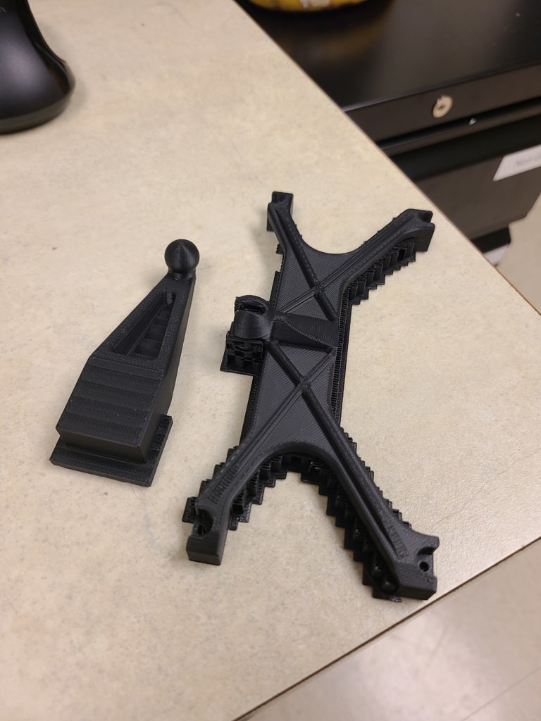

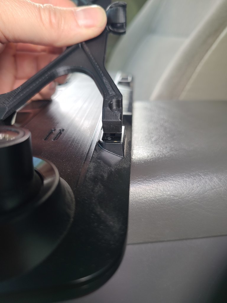

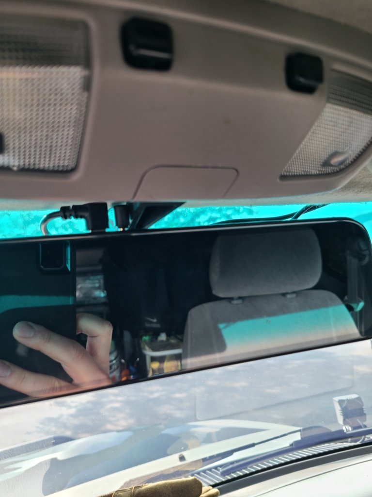

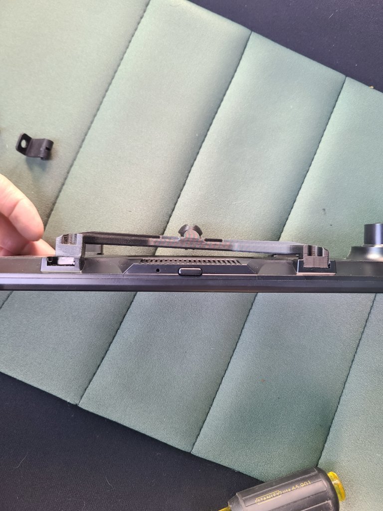

    I created a direct mount for the 1st gen Tacoma and Wolfbox G930. I didn't want to spend the $150 for a fancy aluminum stick from SQR, but was also super annoyed by the crappy rubber band attachments and interference with the sun shades. So I 3D printed one. The Mount allows for both sun shades to come down with no interference.
    I have 2 prototypes I am happy to ship for $5 and the cost of shipping.
    The mount was 3D printed on a SLA printer and uses a #8-32 heilacoil to mount to the truck (I did not have metric heilacoils to use the OEM screw).
    You can make your own from the files below. I cannot guarantee this will work on a FDM printer because I designed it for SLA.
    https://www.thingiverse.com/thing:7005382
    Not sure if I wanna sell it but maybe if you ask nicely Ill make some more.
