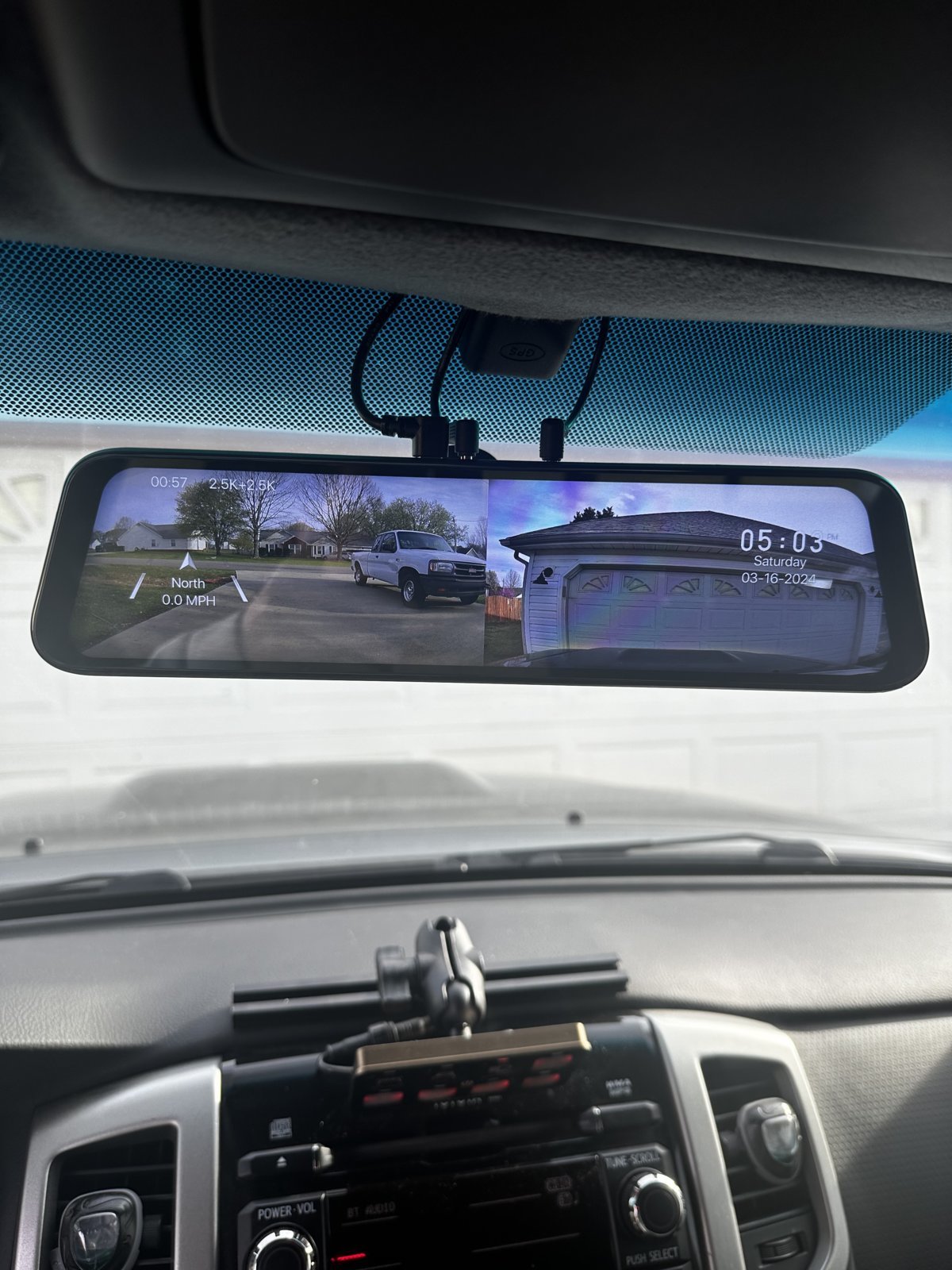

    Starting a thread for reviews, mods and install help. Just completed the install on my 2012 Tacoma. Very impressed with the camera and screen quality. Although the OEM bracket (Model 1) was not confirmed to fit a 2nd gen tacoma on their website i made a pretty good assumption that if it fit other Toyotas it should fit the 2nd gen and i can confirm it does.
    https://wolfbox.com/products/wolfbo...ng-monitoring-dash-cam?variant=47597947781409
    https://wolfbox.com/products/wolfbox-oem-bracket-for-smart-mirror-for-g900-g850-g840s-g840h

    Looking into getting this also, do the visors still fold down without hitting the mirror?

    Yessir!

    Does that mounting orientation cause problems for the GPS? I was under the impression that a specific side MUST be facing the sky.

    If you opt for the bracket/arm yes, the driver's mirror will hit the wolfbox if you have it hanging off the side of the OEM rearview mirror. (Third gen anyway)

    Haven’t had issues, compass and speed work just fine on the display.

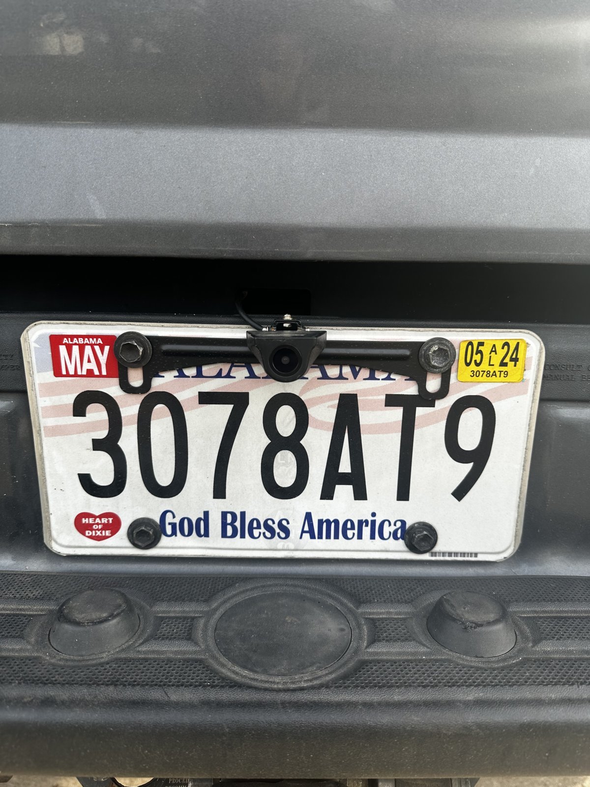

    How much extra wire did you have for the rear view cam?

    Not much, I have a DCLB and the wire length was just enough to reach the license plate. And it’s only one cable to hook up the rear dash cam.

    can you explain how you ran the wire to the back plate ?

    From the headliner, down the a pillar. Under the driver side carpet there is a rubber grommet where some other wires come through, then its just along the frame rail to the license plate.
