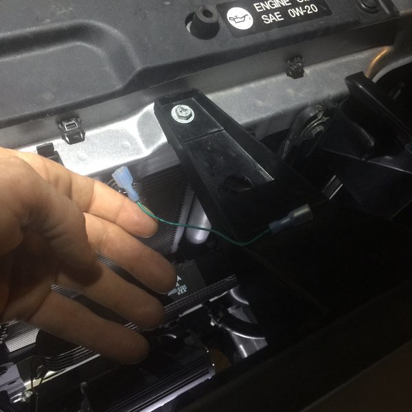

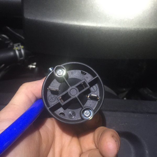

    Ok - so I took out the factor horns which only had one positive going to both of them. Went to put this guy in and my question is do I just go from the compressor negative straight to the negative on the battery? I just want to make sure that the positive coming from the factory horn has a relay and fuse on it so I don't blow things up. I'm just confused as to why there was no negative on the factory horn. Thanks guys.
    instructions for one wire setup. doesn't work with just one positive plugged in. needs negative wired for it to work
    ________________
    these two are tethered together....its just coming from one positively charged wire
    _______________________________
    The hammer likes this.

    The reason there is no ground wire on the factory horn is because it's grounded through the mount. For your install, you should use a relay to do it properly.

    Make a short ground wire and attach to the a good grounding point and you're good. You DON"T need to add a relay or anything, as the factory wiring has all that, just like the instruction indicate. It will work with the factory button, but you will need to swap out the fuse with a 20 amp(the factory uses like a 10 and won't last long) that is required for the horn.
