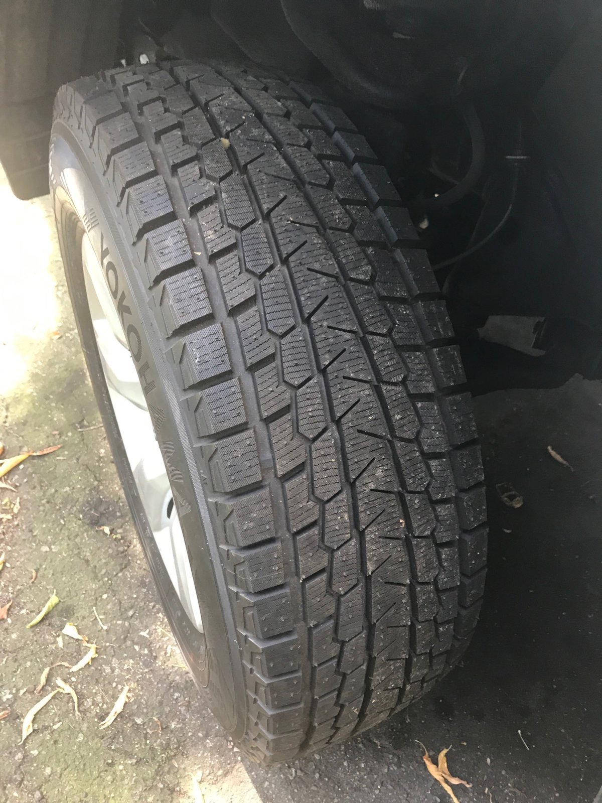

    Just be sure you get those mounted on separate rims..Steel is a good choice. Can take a lot of abuse and unlike aluminum will usually bend during impacts whereas an aluminum rim may crack and lose all the air. And if mounted on separate rims you can do the swap over in your driveway yourself...Lots of good tire choices out there. Try tirerack.com , lots of testing and comparisons, video's and reviews
    Neighbors had one set of rims... After 3rd mount/dismount of summer/winter none of the tires would seal anymore.
    I run the same size summer tire 265/65X17 but downsized to 245/70X17 for my winters. Same rolling diameter so no issues with speedo. Narrower is better in the winter and the smaller size is also cheaper. I run Yokohama G075's found then to be decently priced and long lasting..
    Place I bought them from in Canada mounted and balanced and shipped then for free. Lots of places like that in US.

    May want to check your math on that one unless it's a typo. 245/70r17 is definitely smaller than 265/70r17

    Yep typo ... Original was 265/65X17 winter 245/70X17
    Revs per mile 660 661 Diff -0.3%
    And I agree on the blizzak.. My only concern previously was that I was commuting and would wear out the sticky multicell portion of the tread (top 45%) quickly.. But now that I no longer have to commute the would have been a better choice that my Yokohama's. Will look at them again in 8 years when its time to retire the current ones :thumbsup:
