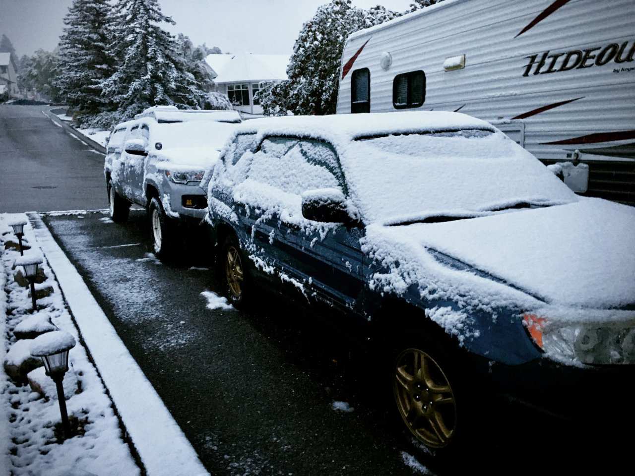

    Put on the winter yesterday.. and today;

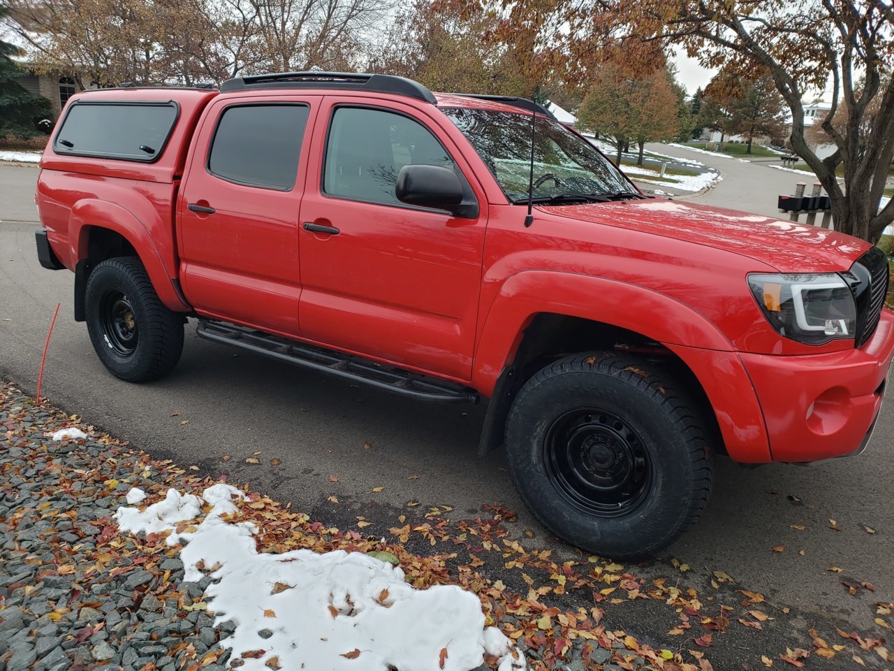

    Ok, the 265/75R16 Hakkapeliitta LT3's are on. Mounted onto Toyota OEM steelies. Last week i had a set of Toytec springs, fresh Bilstein 5100's, and a new front passenger side bearing tossed on. Ready for winter!

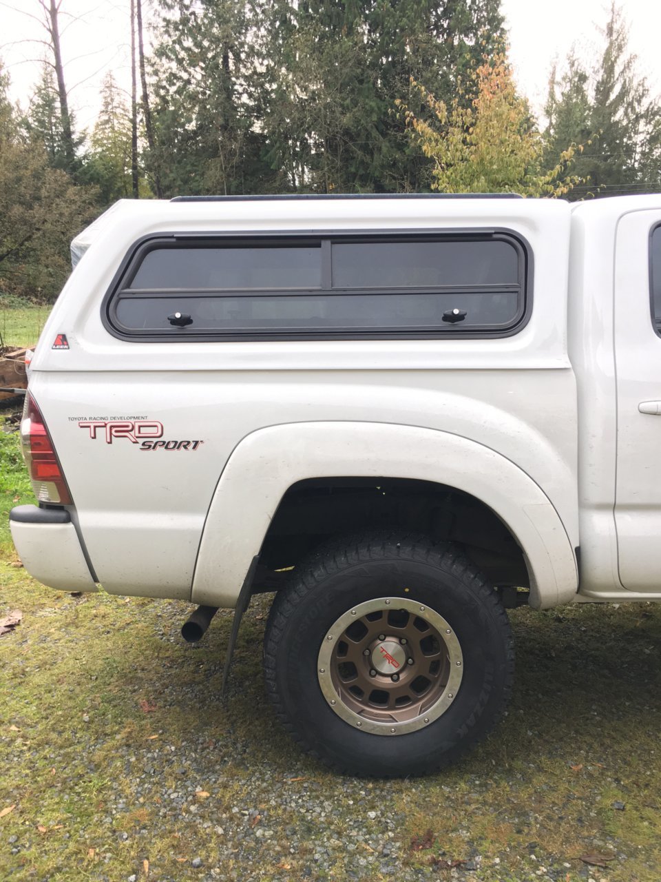

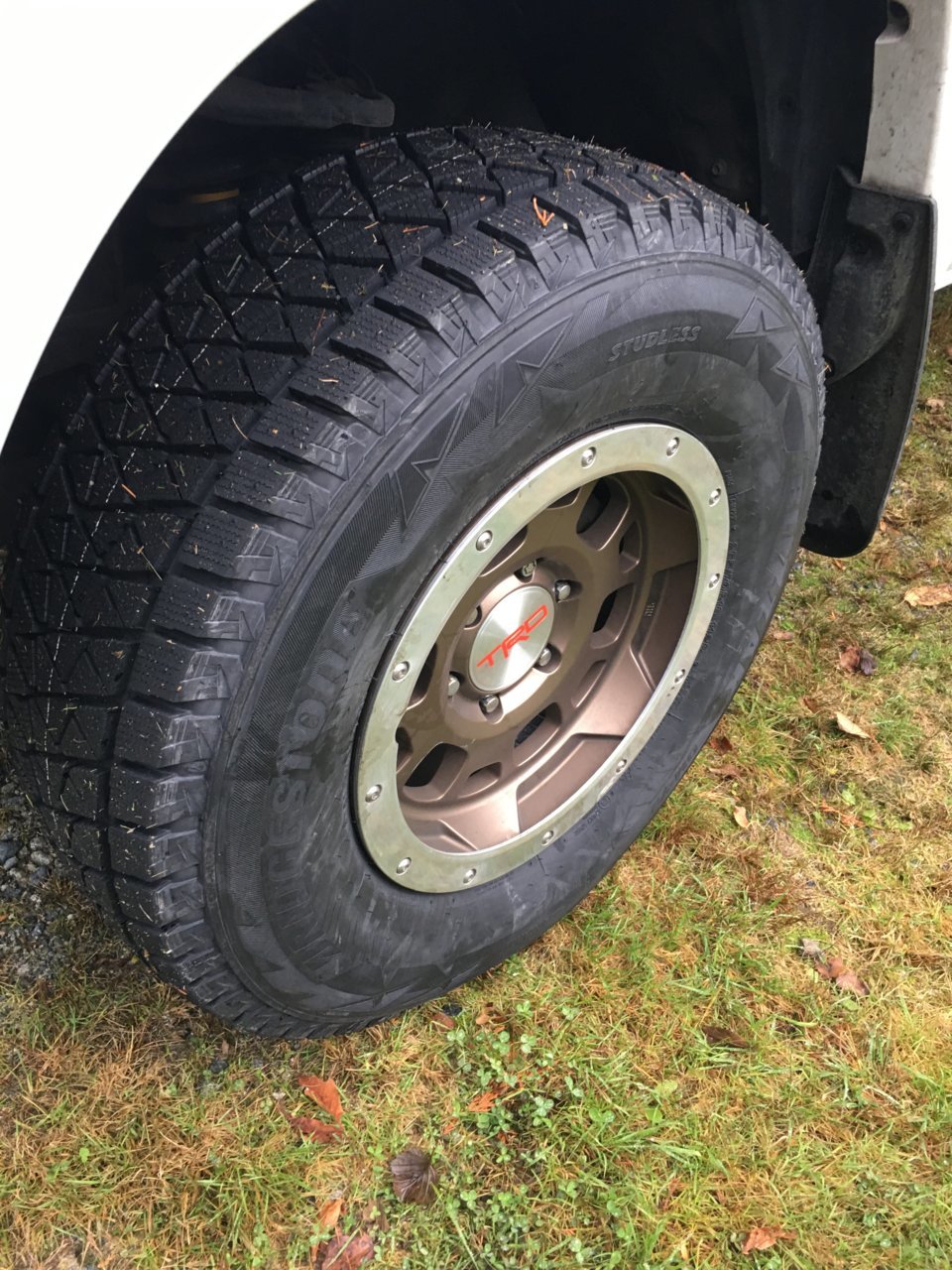

    My BFG Winter Slaloms, bought used 7 years ago with shown rims, had to be replaced. Was going to go with Hakka R3 SUV but opted for the Blizzak DM-V2s instead. I've run Hakkas on my Civic years ago and they were great; Basically opted for the Bridgestones this go around based on shop availability.
    265/70 r16
    Fye123, vicali, Westsideott and 2 others like this.

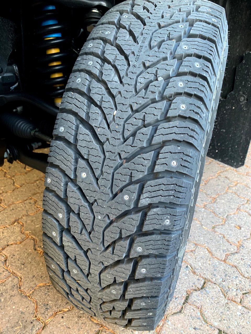

    265/75/16 Nokian Hakkapeliitta LT3 Studded.
    F07E7D8C-FF54-4D61-B1C5-4F1F1F567A8B.jpg AF9DB5D5-875C-4913-AE58-8F0FA3138C27.jpg

    Don’t think it gets better than that
    Rx7turbo2[QUOTED] likes this.
