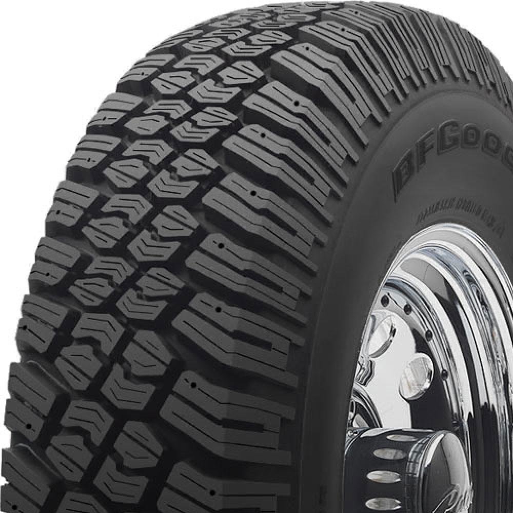

    BUCKLE UP! It makes it harder for Aliens to pull you out of your Truck.
    BFG Commercial T/A Traction tires have been superb and they’re able to be studded 500E7B3A-A906-4755-8491-02276D987520.jpg
