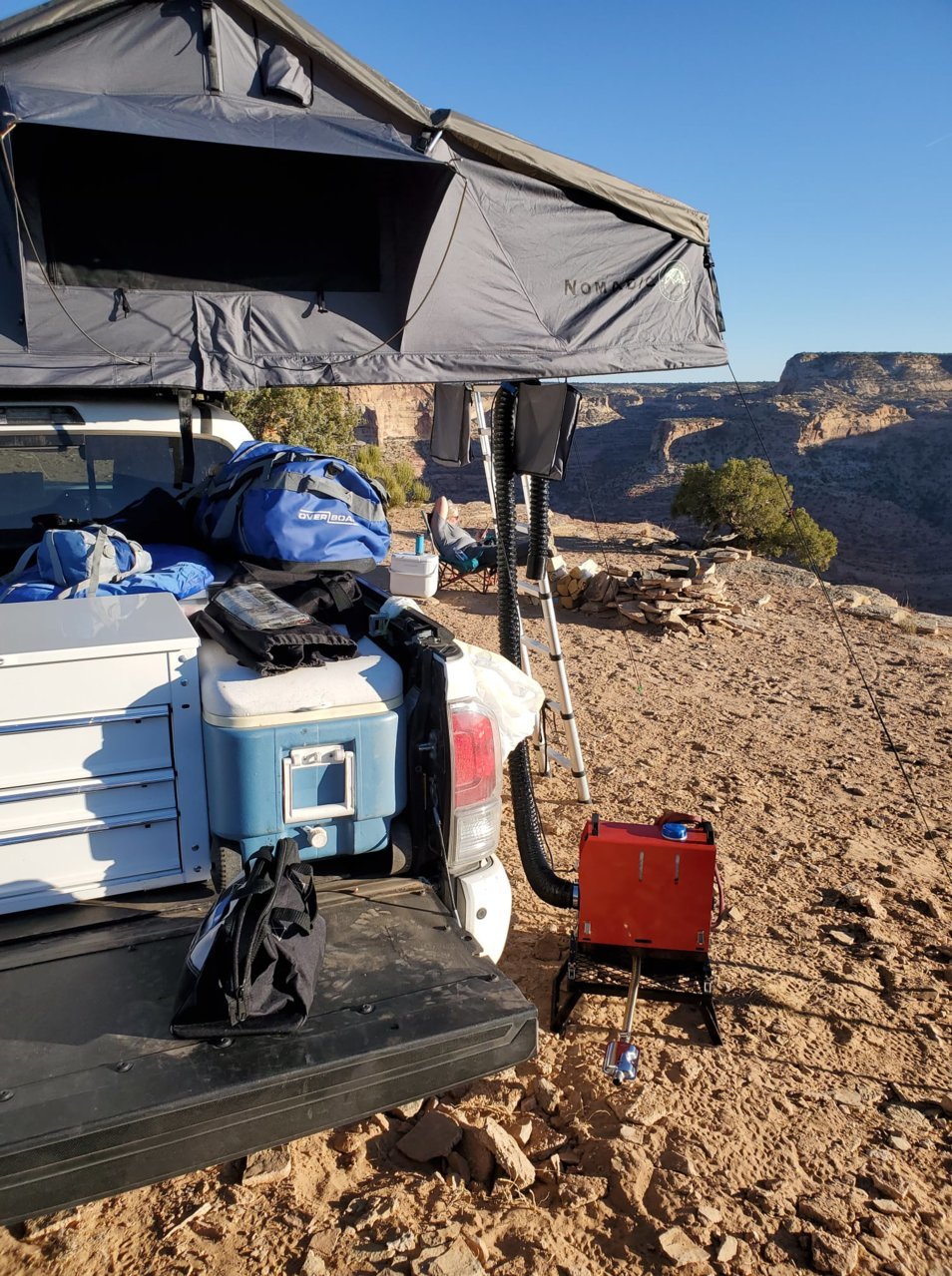

    I vote CDH as well. I have an all-in-one from Amazon. Most any of the Chinese Diesel Heaters are the same, except for the electronics and controls. I paid around $150 I think for a 5K. This picture is us camping in Utah where it got down to 18 degrees overnight. I extended the controller wire up into the tent, along with bolting it onto a small foldable fire cooking grate to keep it off the ground. It kept the tent at 75 all night long using about 3 liters (1/2 a tank) of diesel.

    What are you using for a battery source for the CDH?

    I have a Deep Cycle RV battery from Wal Mart that I take along. Cost around $100, but I already had it to run my fridge. You could run it from a Jackery I think. The heater pulls something like 10 amps on startup to heat the glow plug, but once running it only pulls 2 amps. Keep the power cords short to minimize voltage drop.
