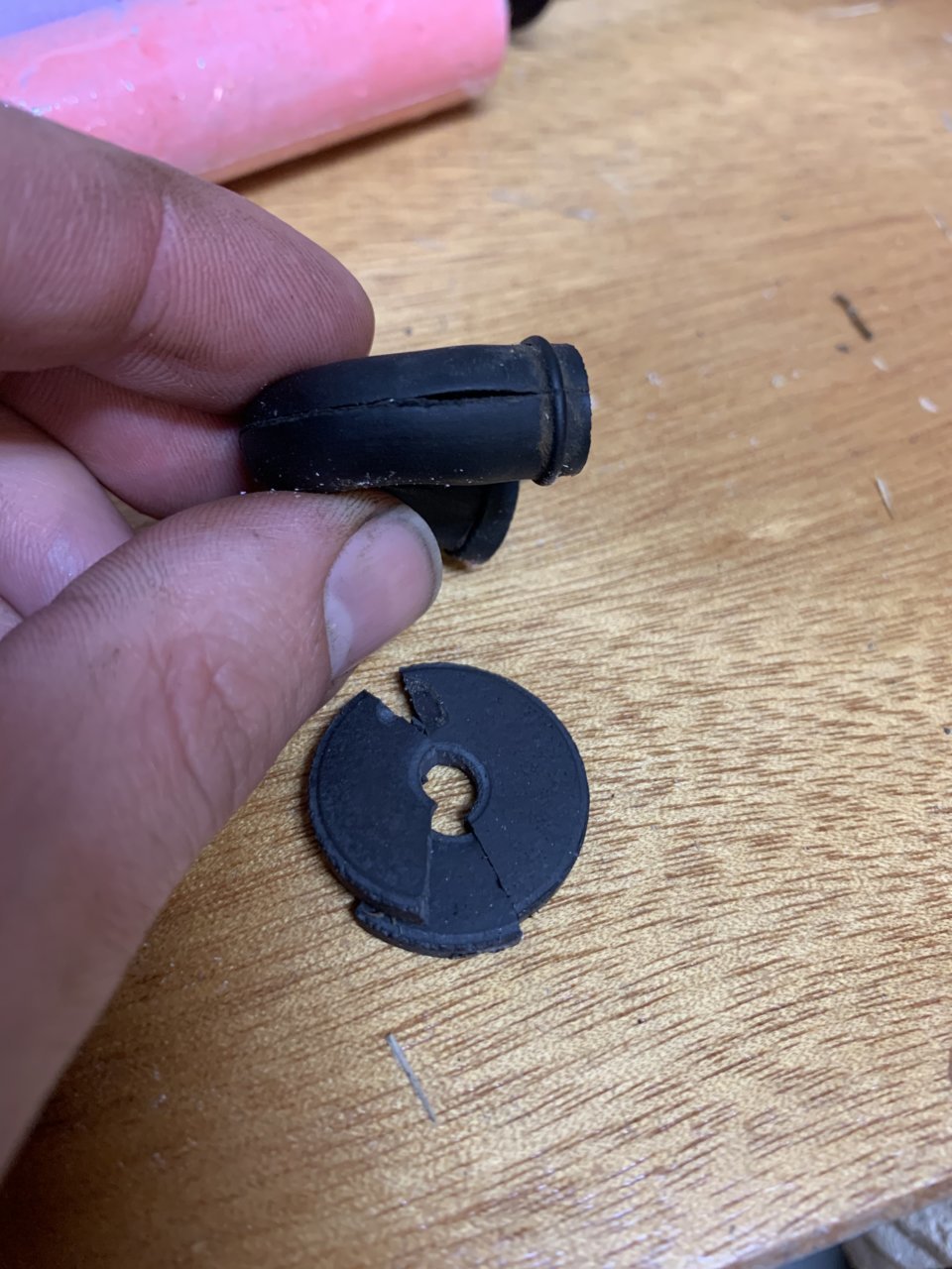

    I replaced my windshield washer reservoir today only to find out it was just the hose connection at the bottom cracked.
    anyway after I was cleaning up I can across this washer looking magnet; anybody know if this piece came off the truck?

    that tube looks like a breather off one of the lights
    no clue on washer

    It’s the tube coming out of the windshield washer fluid container. It was why it was leaking;

    I just replaced my windshield washer fluid reservoir on Saturday. The filler neck was cracking bad as they seem to do. I don't remember coming across anything that looked like your washer. I swapped the U shaped hose that cracked on you to my new one. Did you replace the U or just bend the tubing around to connect?

    I had some vacuum hose laying around and cut it long and used it. I had the same crack on the neck but my leak was there in that U hose.

    I guess I should cap the thread off with the lesson learned Which is to check the U tube leaving tank for cracks before replacing the whole thing; it could cost you 99 or more bears depending on what you like to drink!
