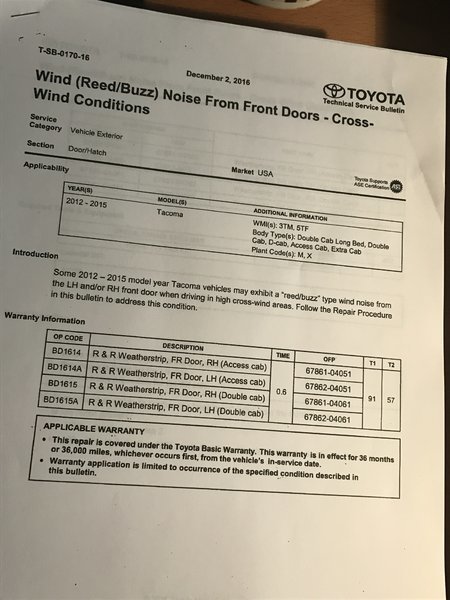

    Someone just posted a thread where a TSB was issued to solve the issue on 2nd gens.
    I'll try to find it.

    https://www.tacomaworld.com/threads/15-sr5-dcsb-wind-noise-solved.402034/page-9#post-14127676

    I linked the information to the TSB. I'll quote it below.
    It's a known issue. Go get it taken care of at the dealership.
