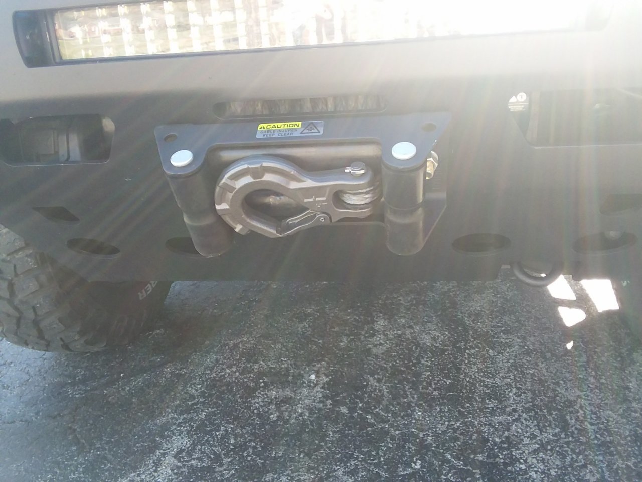

    20180306_102609.jpg I'm 110% behind the strength and quality of the Factor55 thimble I tried. Where I decided. "Not for me" was using it..... A hook is less parts in hand that a flashlight, the thimble, d-ring, pin, and a pair of gloves that have zero feel. Oddly enough, every time I've used a winch was in bad footing or mud or a hill....Ease of operation in awkward situations favored a hook for me. Faster. Simpler. More than adequate.
