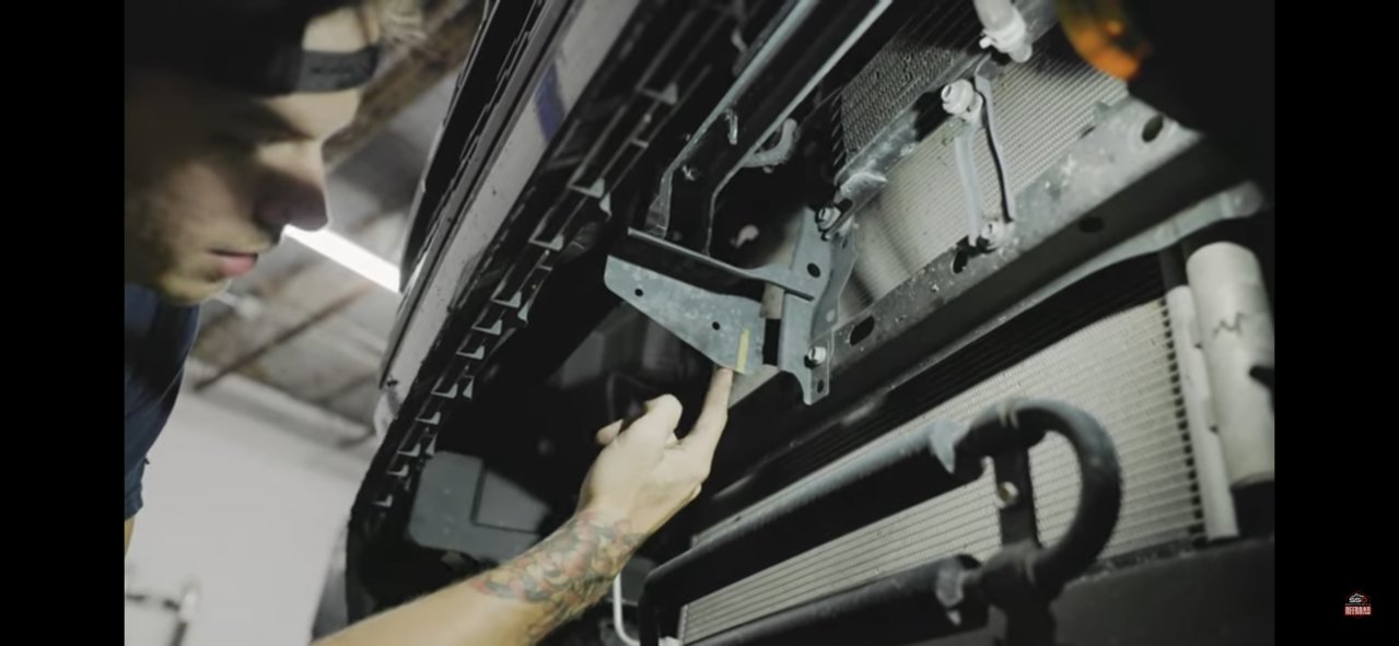

    I’m glad I found this today where an SSO installer shows you how to cut and bend the support bracket so you don’t have to remove the warn control pack or remove the bracket.
    I was planning on locating mine like Classy Tacos did in his videos but now I think I will keep the control pack on top center of winch and just do this recommend
    Go to the 8:25 mark

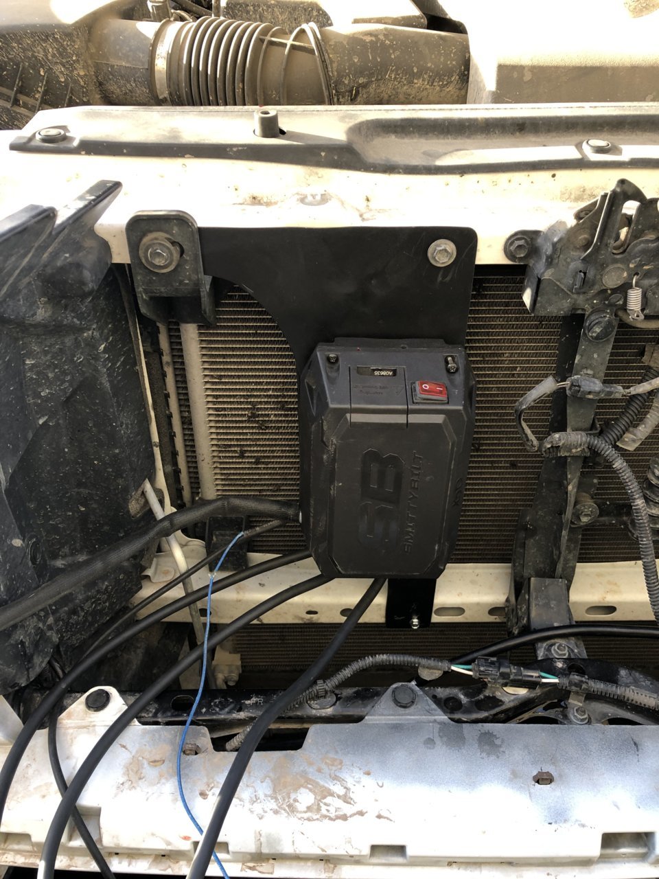

    I used some 0.100" thick aluminum sheet to make a bracket for my Warn Zeon 10S control. It mounts to the bumper support in the front and radiator support in the rear.
    Also if you're looking for wireless control look at the Warn Wireless hub. It's a bluetooth adapter with a phone app, works excellent.
    https://www.amazon.com/WARN-103945-...t=&hvlocphy=9018732&hvtargid=pla-985480371051
    Sorry only picture I have, but hope it helps give an idea

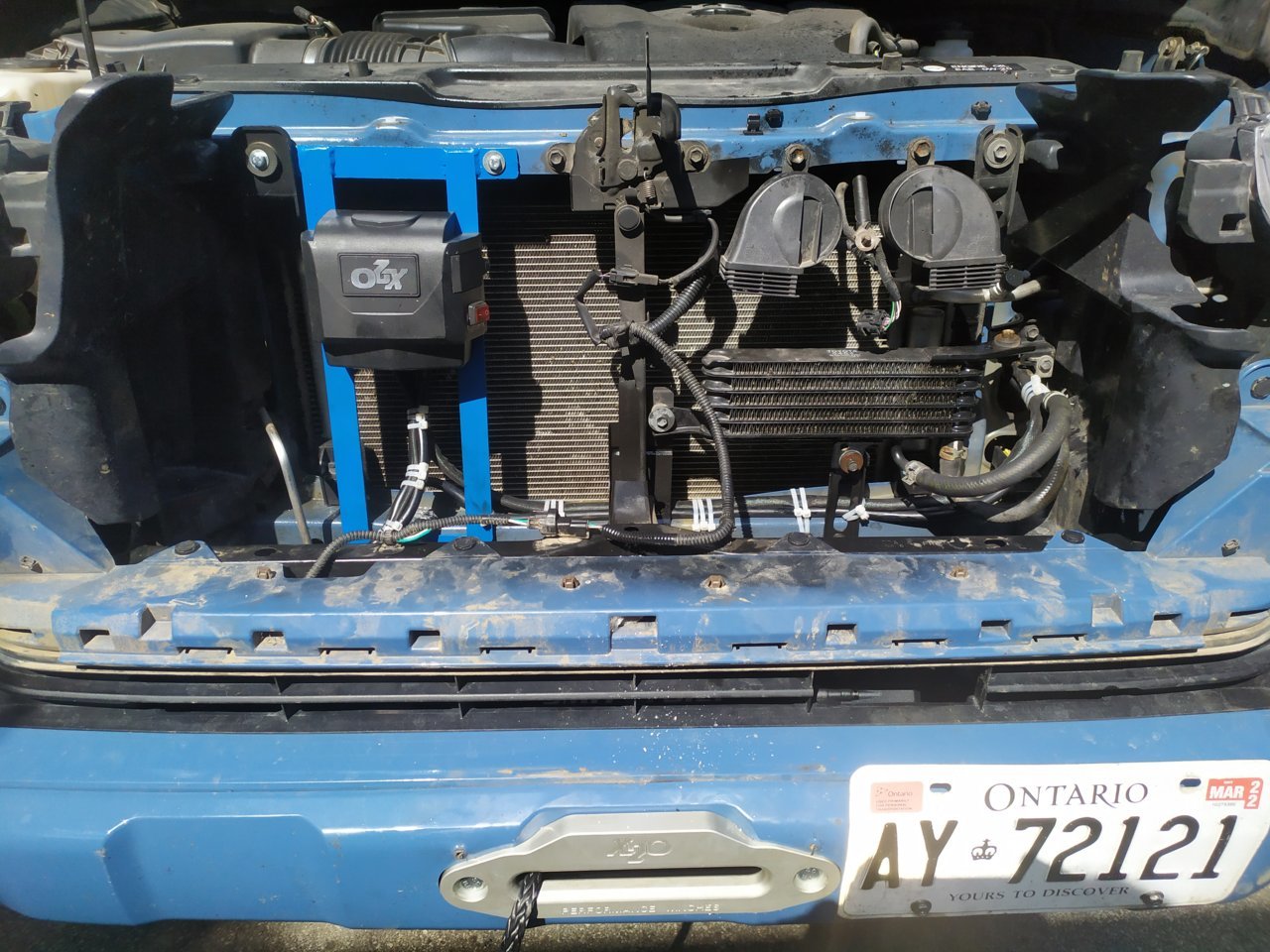

    Makes for easy on/off of the wireless. The winch positioningin the sso bumepr probably isnt too far off. This worked out will all the supplied lengths with the smittybilt

    I was mainly focused on the fact you can leave the warn control pack mounted to the winch and do what SSO shows in this video.
    A much better solution IMHO.
    Keep the factory Tacoma bracket, bend a portion of it out of the way with a short cut, and the warn winch and control pack can stay on top center of the winch easily accessible wired or wireless

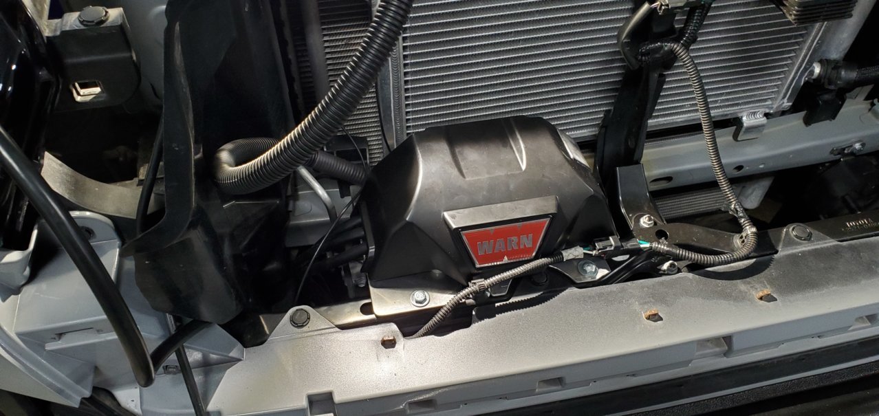

    So to clear the Warn winch I followed the SSO latest instructions where they discuss clearing the solenoid box and just leaving it mounted to the winch.
    I was able to cut the sheet metal with some Wiss snips and then just use some wiss hand seamers to bed it toward the driver side to box it in. Loses no rigidity that I can tell and should provide the 1.5 inch clearance needed for the solenoid pack.
    I then added a couple pieces of the left over edge guard for the sharp edge
    I’ll let ya know how it goes when I mount the winch tomorrow

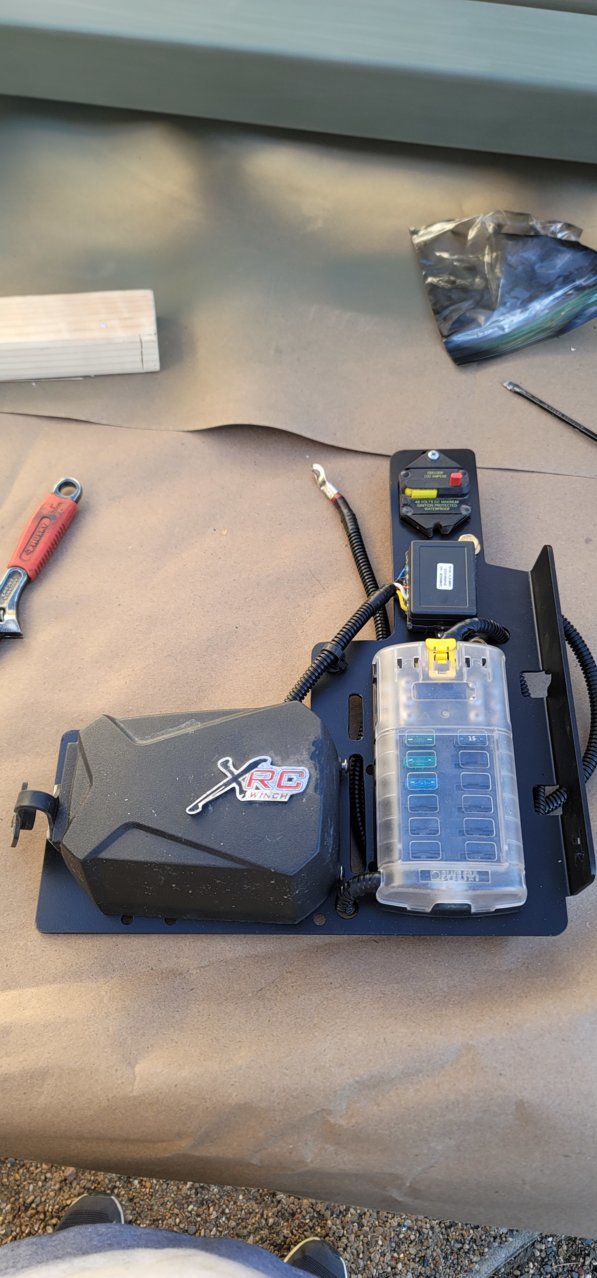

    BAF581E2-C17F-4B02-9A69-B49F1962BED3.jpg Seen a bracket online for $70. Had some scrap steel so I made it and painted it in like 30 min.

    What did you do for extending the wires? Made your own with 1 gauge or ordered a set online?
  19. Sep 5, 2024 at 2:04 PM
    #19
    PainterVern
    PainterVern GoatRoper
    Oct 23, 2019
    #308814
    147
    Vernon
    Reno Nv
    19’OR
    A few things….
    Went to Napa and they made them for me. Was super cheap
