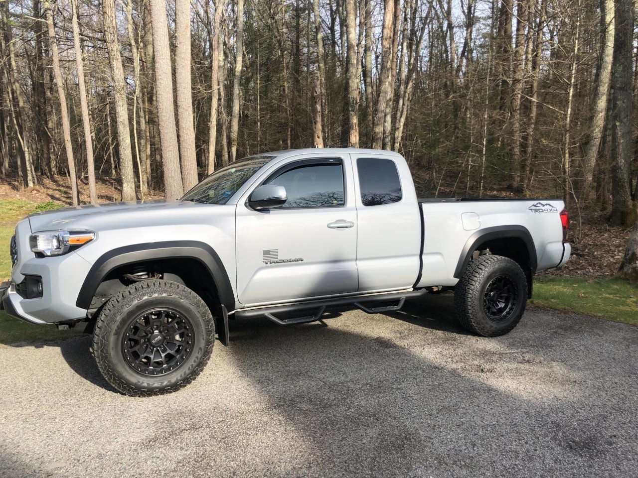

    Appreciate the pics of the poke, thats about the amount Im looking floor. Do you by chance have a side shot showing the tires? would like to see how the 265/70/17s look

    Eibach Stage 1, 17x8.5 Ray 10s, 265/70-17
    here ya go. Truck is on an eibach stage 1. Just under 2” front 1” rear

    Beautiful. Thank you for this
