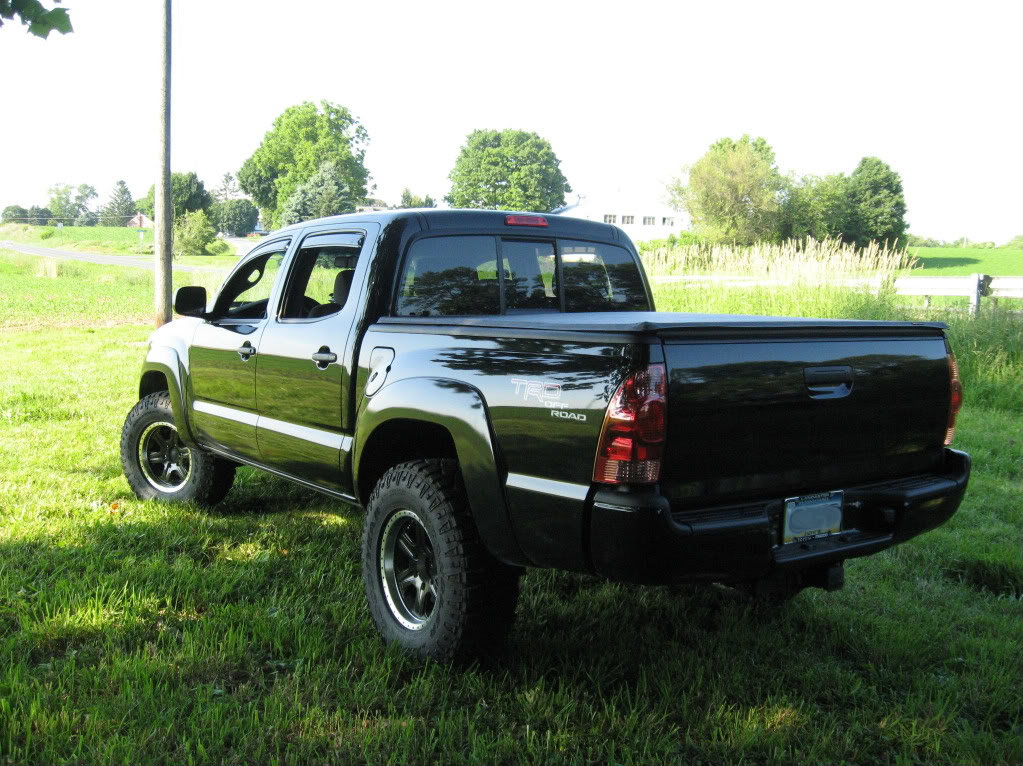

    Here's an old pic of mine back before it was lifted: 16x8 wheels with 4.5 backspace, 265/75/16's (same basic diameter as 265/70/17's), no lift.

    [FONT=&quot]Interesting, what rubs? The bottom of the mud flap, and when you say trim, you mean cut a little off the bottom?[/FONT]

    Well, you will have to see what rubs and take it from there. I removed my flaps as soon as I got it home so I can't say for sure what to trim. Most just remove them. I had a very slight rub when compressed on the fender. It was never that bad though and I lifted it shorty there after.
