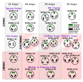

    Since the wrangler is now a plugin, it's only a matter of time before the Tacoma is. Most AC charge circuits that I've seen are plugged in to a 14-50, or 14-30 outlet (both are 4 prong, hot+hot+neutral+ground). 6/3 romex(4 wire) is much more expensive than 6/2 (3wire).
    The couple charger wiring diagrams don't have a hookup for the neutral so it would be wasted. In an effort to future proof the installation, is there any reason to run the extra neutral cable?
    As for the plug that connects to the vehicle. There are 2 basic (common) types in norther america. J1772 which are the ones you see at grocery stores, and Tesla which are not. Picture below.
    The Tesla mobile chargers have 2 addition pins that are unused right now.. picture below.

    The reason they use a 4 wire receptacle is because it is standard for a 50a rv hook up which requires a neutral. The hardwired chargers do not require a neutral.

    Put a level 2 charger in my garage. I pulled 4 strands of 6ga through conduit to the outlet it plugs in to, just to future proof it, but because the charger was wired for NEMA 5-50, I just hooked hot/hot/ground up to the receptacle, and terminated the neutral in the box behind it. So yes, I could have gotten away without running the neutral, but that’s very dependent on the manufacturer of the EVSE, and whether they provide the option to wire for three prong vs four. If I had to do it again, I’d still spend the money to pull the fourth wire, just to be safe. If you’re running romex, you especially don’t want to have to do it again.
