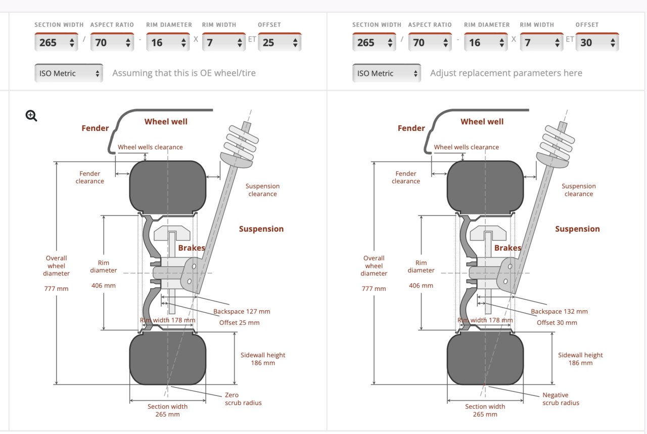

    16x7

    Toyota uses +25 mm and +30 mm offset wheels on the Tacoma, depending on the wheel width.
    The scrub radius of the 2005-2023 Tacoma 6-lug with +25 mm wheels is approximately +20 mm with stock sized tires. (Current stock offset for all models except TRD Sport with 7" wide wheels)
    The scrub radius of the 2005-2023 Tacoma 6-lug with +30 mm wheels is approximately +15 mm with stock sized tires. (Current stock TRD Sport offset with 7.5" wide wheels)

    I found this caculator it say the OE has zero scrub radius and the new wheels will have a negative scrub radius. says new scrub radius will be -5mm. I also read negative is better? Thoughts? Thanks in advance.

    It is also more than I expected to be honest. As I said, the numbers are approximate, I found them by reverse engineering some Toyota engineering drawings.
    The fact that Toyota uses both offsets being considered on the truck from the factory should put OP’s mind at ease at least, even if there is some error in my method (and there is some error in my method).
