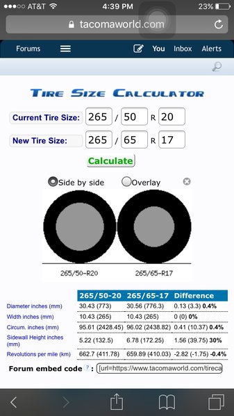

    My tires are 32.71 and 11.22 wide were your tires are 31.91 and 10.83 wide so off set is important so the tires don't rub. The rim size doesn't matter, I have an other set of tires they are 265-70/18 they are 32.6 and. 10.5 wide.
