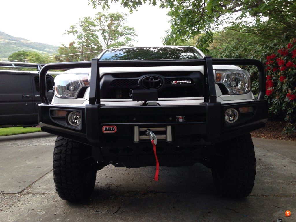

    Hey everyone! So I finally got to installing my arb bumper and winch. I was actually able to put in my 12000 pound badlands winch! We had to grind the lever that releases the spool on one side with a band saw in order to fit after we rotated it. Other than that it bolted right in! Here's a pic of the finished product... I will try and get some more of the actual winch but just wanted to let everyone know that it does work. And it's a awesome cheap option from harbor freight for some serious pulling power. mytusaju_dcde1827df0ff0a8bb42e763a65b5e78ddde8da7.jpg

    Nice dude! Oh and hello from Medford!

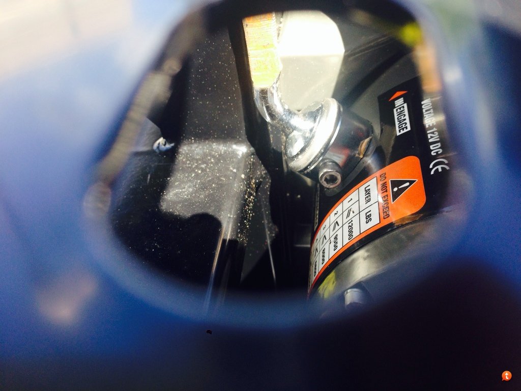

    Can you post a pic of the grinding you had to do after you clocked the clutch?

    Here's the best pic I could get. We had to grind 2 sides in order for it to swing down all the way. Need to plasti dip it next. yqasyqy5_47bd7acf3856afc07ce86e7aa8b1f8db0ffb0d05.jpgtery3eqy_569e2d55be0b29e14301cabb15386ff60703e815.jpg
