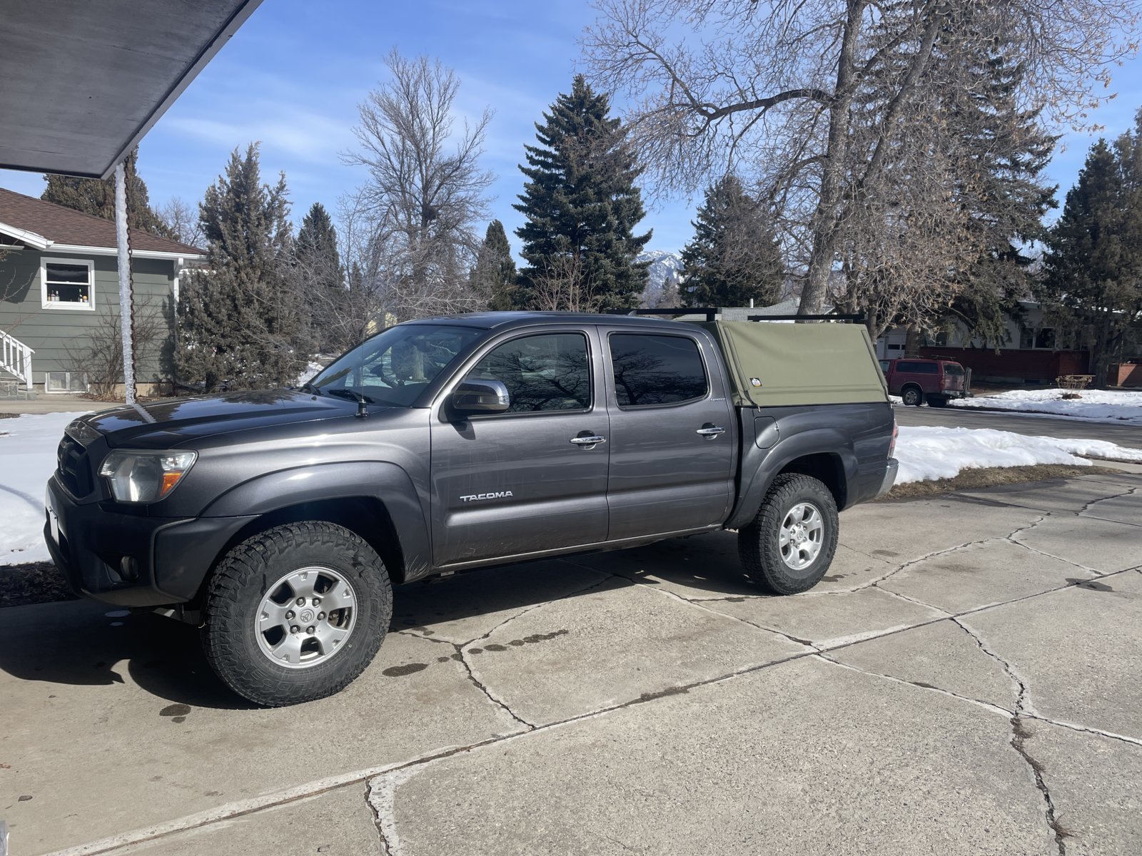

    I wanted to start a thread about these, since they’re pretty new and there’s not much information out there. When I was researching these before buying, I only found a thread in the third gen section, and on gladiator forums. I pulled the trigger on a green one for my second gen. I’ll share some thoughts and photos here for anyone else looking into them.
    I’ve been through a few topper iterations with this truck, starting with a second hand softopper. I liked the look of the softopper, and especially liked the weight. On a truck with such a low payload every extra pound of accessories counts. I considered adding a rack over the softopper to carry things like canoes and lumber, but the extra cost and weight kept me from doing it. Then, in its first winter in a cold climate, I had the somewhat common problem of the vinyl window cracking. After this, I sold the softopper and got a fiberglass shell.
    I liked the fiberglass shell, but it was heavy, and the cheaper second hand one I found didn’t have windoors on the sides. I eventually got tired of crawling into the truck to get stuff from the back of the bed, and carrying the weight of the fiberglass shell.
    For my use, the Wildtop seems like it should be a good compromise between the previous to toppers I’ve had. I like the access to the truck bed on three sides with no bars in the way like a softopper. The rack and topper combo avoids the need for a rack outside a softopper. Wildtop advertises a weight around 45lbs.
    Shipping went smoothly, it arrived in just under three weeks from Australia. Not too bad for a built to order product from another continent. Wildtop also guarantees it will arrive in three weeks or it’s free.
    Install wasn’t bad, I think it took me about 3.5 hours start to finish.
    Start with pieces and an empty truck bed
    The frame goes together pretty easily, just make sure the pieces are all facing the correct directions.
    The frame attaches to the bed tracks with aluminum angles. These get attached to the frame with some threaded rivet-like fasteners. Those took a minute to figure out how much to torque them to get them crushed properly.
    These angles were the only part of the install that didn’t go according to plan. The pre-drilled holes in the ones I got didn’t line up with the bed track, so I had to drill some extra holes. Not really a big deal in the grand scheme of things.
    After that, you’ll assemble the load bars, and put the canvas over the rack.
    This is the only installed photo I have so far, but I’ll post some more soon.
    I’ll update this thread with some more in-depth reviews after I’ve had it on the truck longer, but my initial impressions are positive. The build quality seems good, and the canvas seems sturdy. It takes a little longer to get into than a topper with doors, but I like the ability to roll the sides up and keep the whole thing open.
    Hopefully this adds some helpful information about a new product, happy to answer questions or take photos of specifics if there are questions. I’m not affiliated with Wildtop at all, just wanted to put some more photos and info out there.

    I haven’t tried to remove and reinstall yet, but I don’t think it would be too difficult, just remove 8 fasteners at the bed rails and lift it off. The Tacoma version doesn’t seem to have the clip that the gladiator version does. The front panel has a flap that splits, one side Velcroes to the top of the front bed rail, and the other side goes between the cab and the bed. I’ll grab a pic tomorrow. @onewildwest
