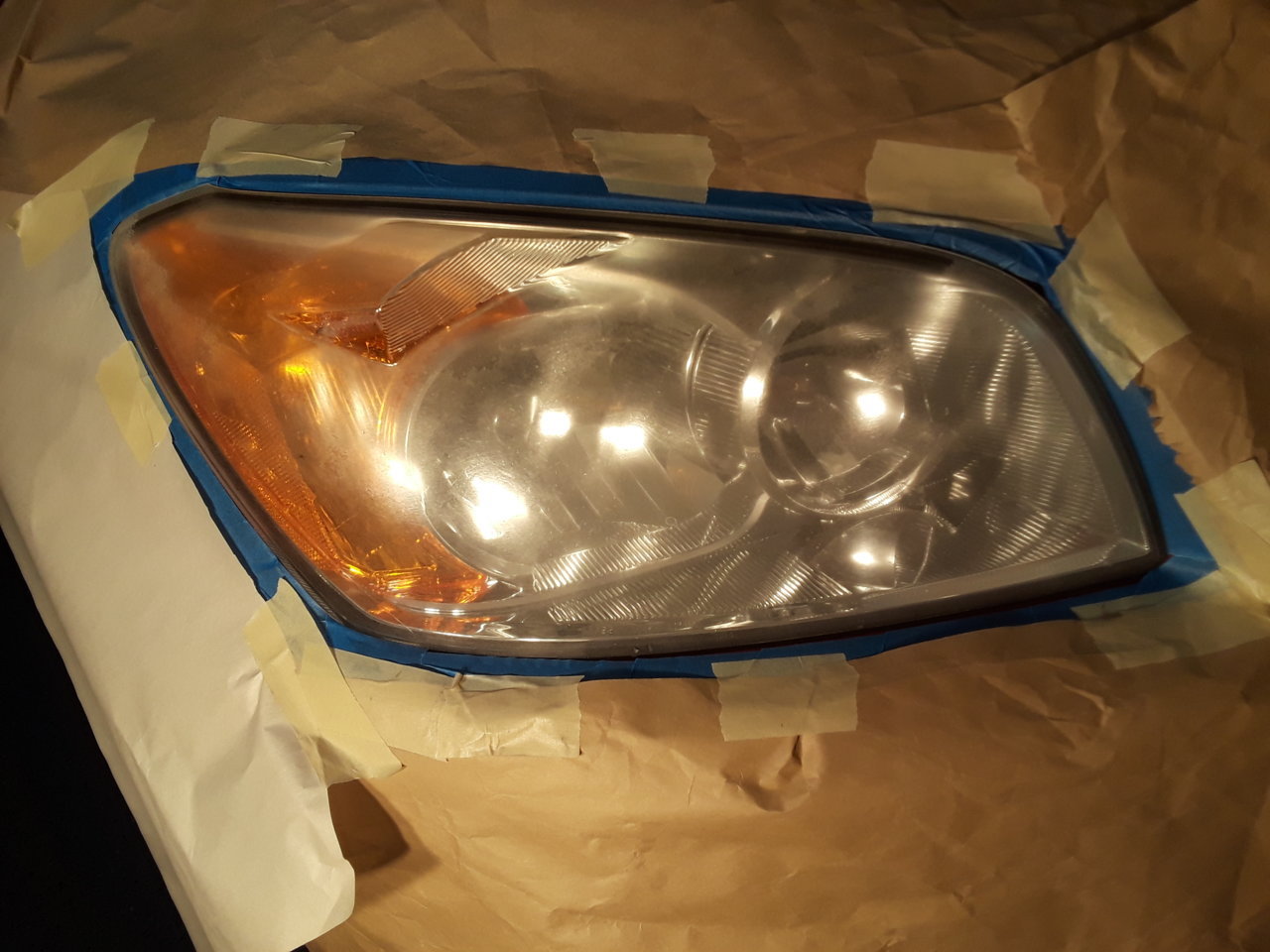

    Before: Wife's 2011 Rav 4. The pics don't show that well but you can see it fogging and see the edges of the restorer crap. This all has to come off (and it didn't, see below.) I rough taped and masked the lenses off to reduce cleanup and prevent burning the clear coat of the paint during buffing where it comes close to the lens.

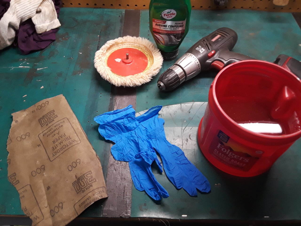

    Tools required, 320g, 400g, and 600g wetodry sandpaper, gloves, bucket of water, drill, buffing pad, fine polishing compound. Not shown is masking tape, scrap paper, and regular paste car wax. The more experienced of you will want to use a more aggressive polish, but remember these are plastic and can burn easily.

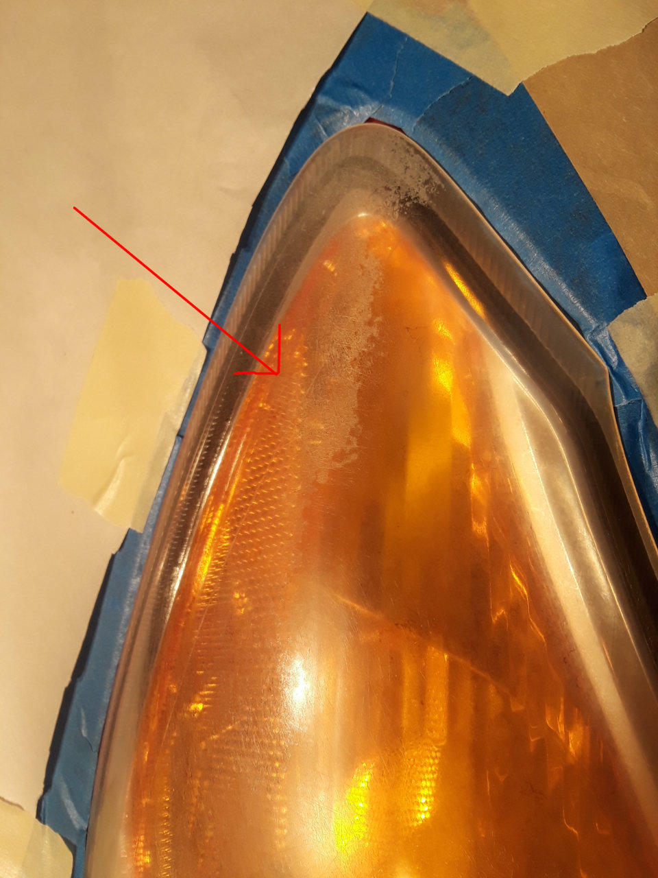

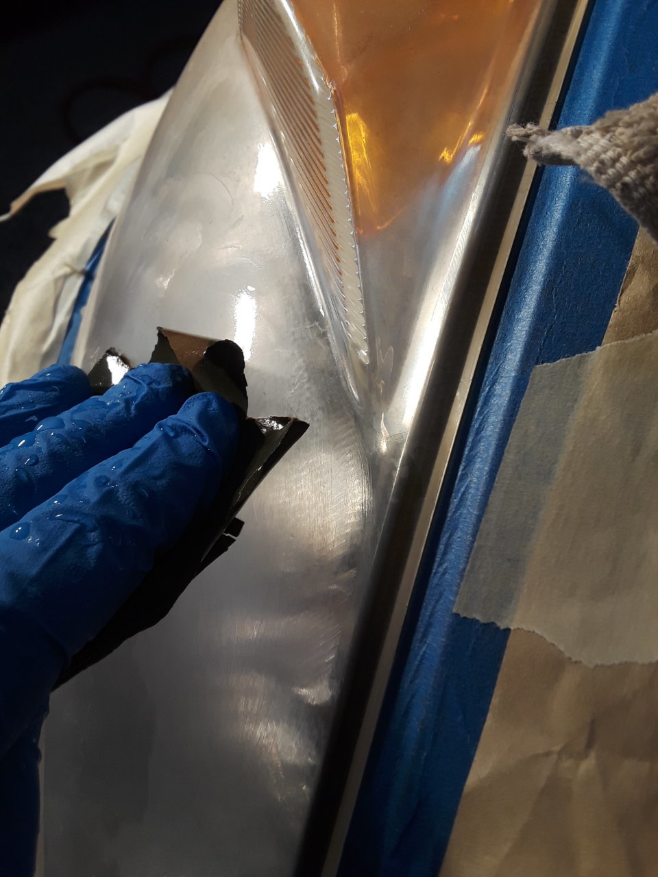

    Wet sand, and focus on the plastic coated areas. I went in with 320g on this and it's just not enough, we're looking at new (expensive) headlight lenses to fully get it out.
    If you look closely, you can see the edge of the "restorer" layer (on the top, bottom is bare lens.) . After an hour or so of hand sanding I threw in the towel, and am not going to get more aggressive with sanding. Finish it off with 400g first, then 600g.

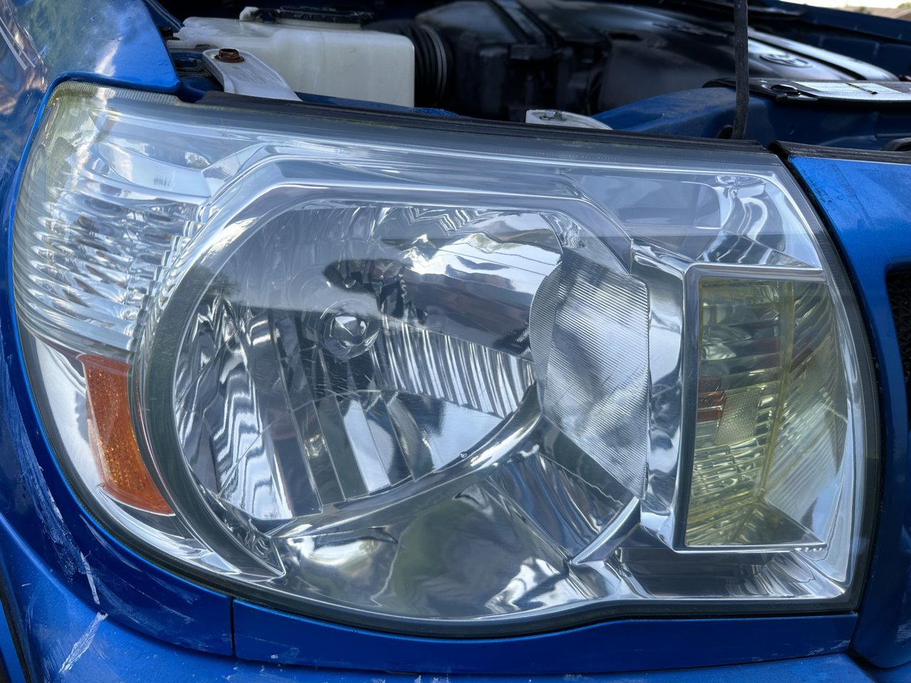

    If you want to keep them new looking and not oxidized you need to apply a UV protectant. If you don’t they will fog up again in a couple months. I did my lights over 3 years ago and they still look like new. I did touch them up a little once but not a complete restore job. My truck is outside 24/7. The UV protectant I use is Meguiars Headlight Coating. Instructions say to apply once a year but I spray it on the lights every 6 months. Takes a few minutes. Easy peasy. Guys always complain that they restored their lights but the oxidized again in a short time. That is because they didn’t protect them.
    Here’s a pic of one of my headlights 3++ years after restoration and a pic of the protectant I use.
