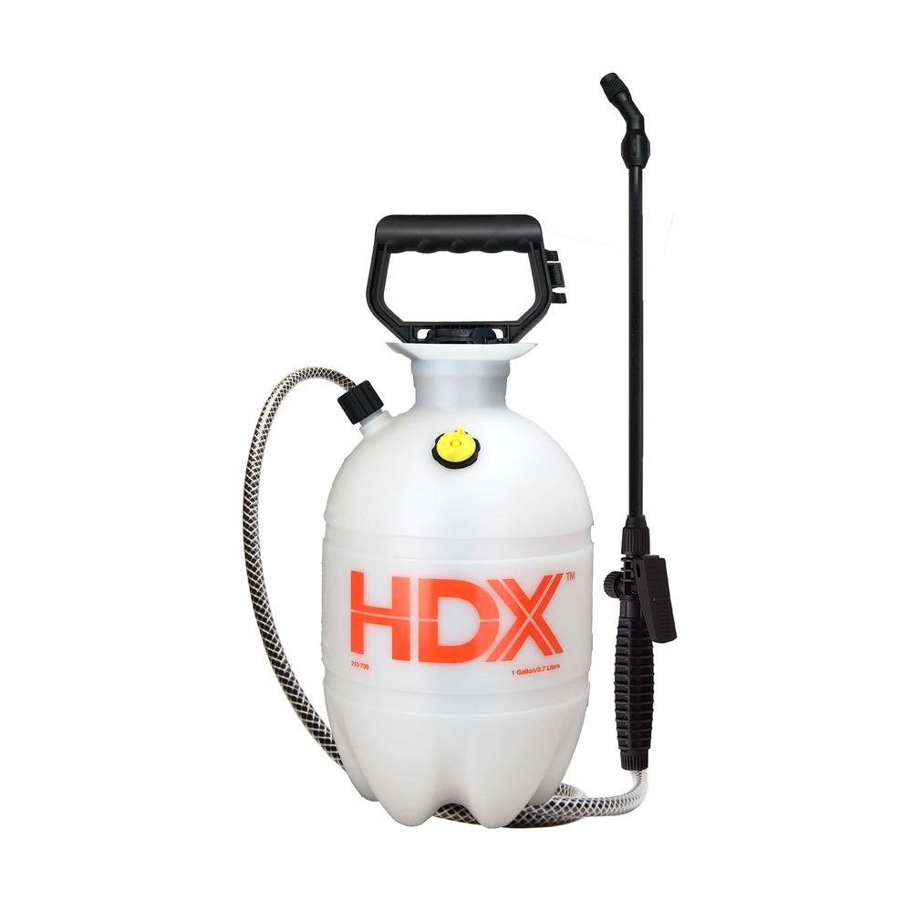

    on the recommendation of a friend I picked this up at home depot for $10. It work wells but a bit slow when using 75W-140 for my Ram's rear diff.
