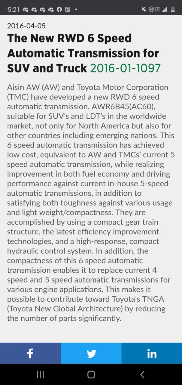

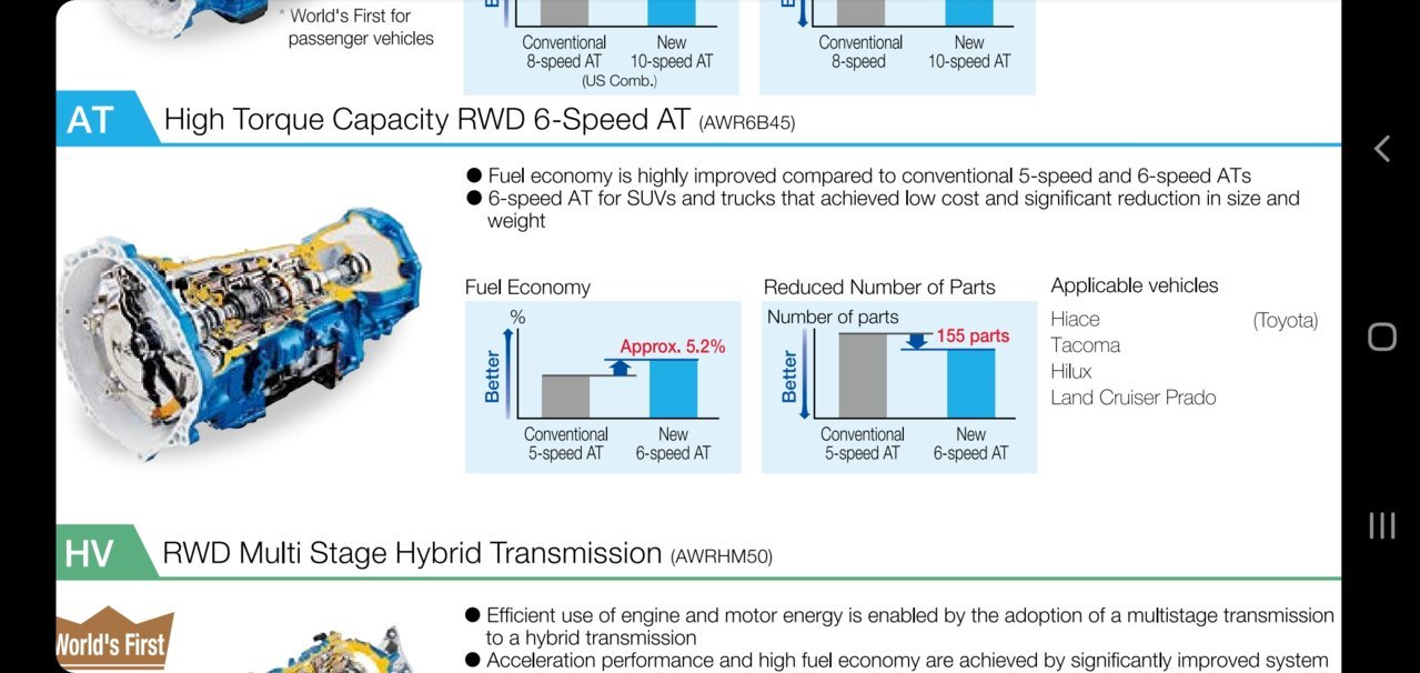

    I've seen a lot of hate toward the Aisin AC60 transmission that comes in the 3rd gen Tacos, but I love it. Why?
    1. Fewer parts, simpler
    2. More efficient, lighter
    3. 2 overdrives
    4. ECT-i (SelectShift)
    5. Smaller, compact

    I checked out the paper; ~440 N*m for torque, which converts to ~325 ft*lb. I think I recall Mat w/OVTune saying the transmission was rated for more than 325 ft*lb.
    This line-up reference (https://www.aisin-aw.co.jp/en/products/drivetrain/lineup/at.html) shows 450 N*m, or 332 ft*lb. That seems low compared to how Mat's been hammering on his.

    My favorite part is on page 5:
    AWR6B45 (AC60E) Has achieved enhanced durability compared to the 5 speed.

    Pretty sure it’s good to 450/500 clutch and flywheel probably around the 325-350 range
