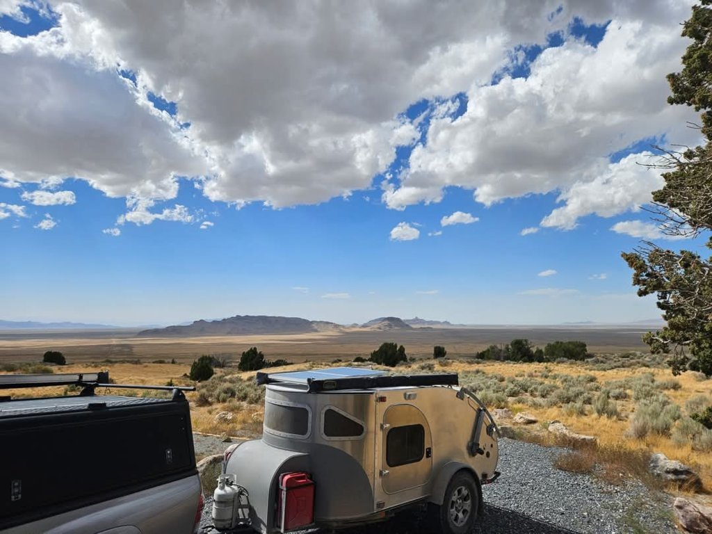

    Old pic I snatched online; his company used to be Rockbox Offroad and he made specialized off-road trailers he would rent out or sell
