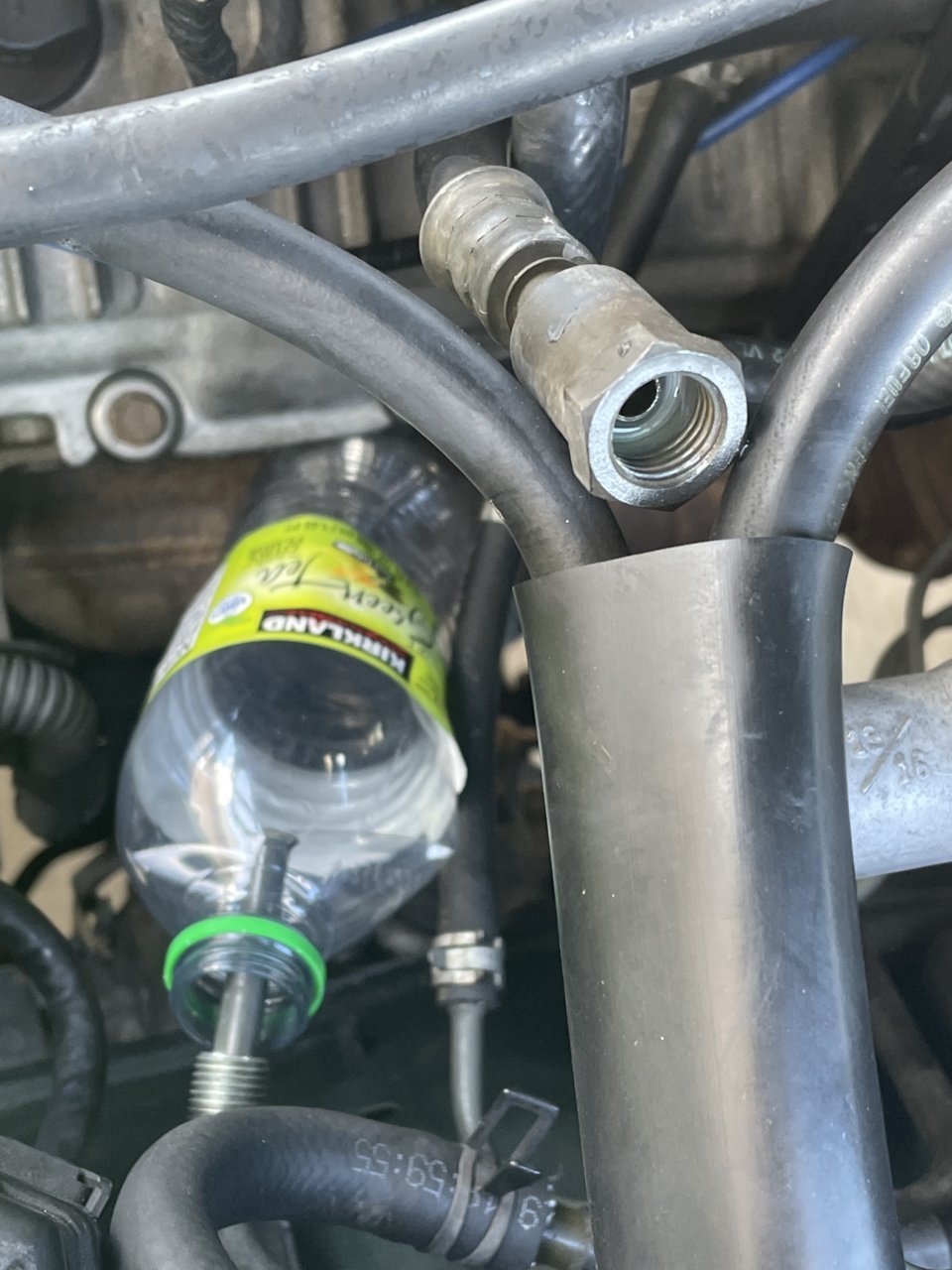

    Ok, so after i got home friday and got into the driveway under its own power, saturday( yesterday) i changed the short U Evap hose under the hood at the green relief valve, it seemed a little dried up and also the HOSE between the PVC valve and throttle body.. it was hard as a rock. Tired to start the engine and it wouldnt start! Damest thing ! I cranked an cranked but nothing… so i disconnected the high pressure fuel line and cranked it a few times….. nothing! No fuel shooting through. I cant believe it has something to do with my timing belt change… unless something disconnected,etc. prevents the fuel pump from turning on or it is as simple as… maybe the fuel pump crapped out? That would be some timing right there for that to happen. What do u guys think? Oh, the Ign. , efi fuses are good. Is there a fuel pump fuse? Or some other designated fuse i may have over looked?
