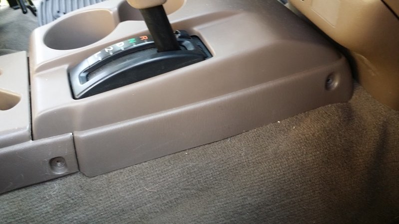

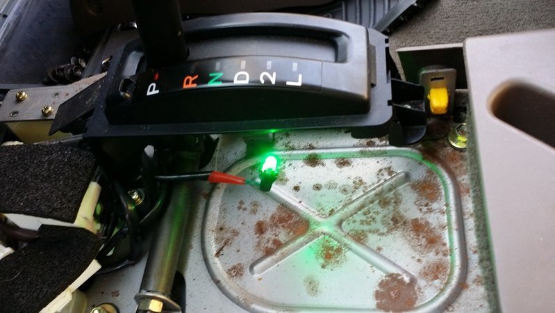

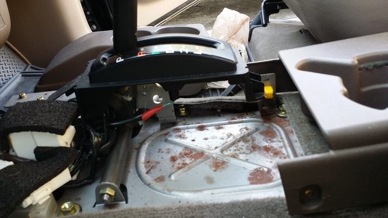

    Here is my 2003 Tacoma tranny light replacement, as posted in the 2nd gen forum, cause I didnt know this existed.
    1) Swing back armrest, open little door for lower storage, remove 2 bolts.
    2) Loosen 4 screw head bolts (2/side) from sides of AT shroud.
    3) Lift up AT shroud rotate 90 degrees and remove. During this it will be necessary to lift up the front of back panel that goes to the armrest (where the rearmost 2 screws to). Just lift it up 20 degrees to do what you need.
    4) Unscrew the illumination bulb. Hint, its the one with red on the wire underneath. I think it loosens clockwise and tightens counter, you can figure it out, you have the technology.
    5) remove bulb and insert LED. Turn on headlights, if it doesnt light up, remove LED, rotate 180 degrees and reinstall. I had to do that. I was using a shop towel/paper towel the entire time when holding LED to avoid finger oils.
    6) Secure light, and reverse above steps.
    For my 1st gen, the LED used was a type 74. I ordered from SuperbrightLEDs and it is listed as
    74-GHP3 Volts 10-16V Viewangle 360.
    _____________________________
    So it locks in position, the socket the bulb/LED goes into.
    I had to turn one way before I could pull it down, put in the LED, then go up, and turn the other way to lock it back in.
    Then do the whole thing again, because polarity was reversed.
    This is on a 2003 Taco.

    Yeah it cost me $40 from a local parts recycler. And I did my gear shift bulb replacement already it looks like this. Picture was taken during the daytime
