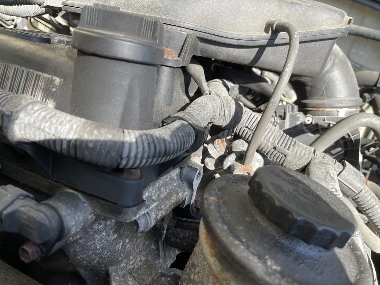

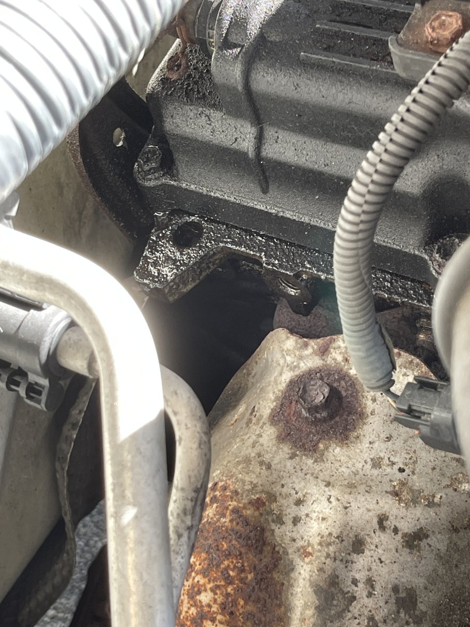

    Recently I realized that white smoke is coming up from the what seems to be the exhaust manifold. (Pics below) There's a burning smell for sure, Im assuming it's oil because of all the caked up black resin on the engine but only on passenger side.
    *Coolant level is right at the 'low' line, so need to fill but I didn't think this was the cause of smoke on a cold start.
    Video of cold start: You can see smoke start to come up at 00:41 https://youtu.be/6l714rKnDpQ
    Passenger Side:
    Driver Side:

    Looks like your valve cover gasket is leaking, should be a relatively simple repair and gaskets are inexpensive so shouldn't be too hard to do if your mechanicaly inclined, if not have it replaced at a repair shop.

    Yessir, that’s what it appears to be in my eye view. Change gaskets & clean up what oil you can. The smoke is it just burnin’ off.

    Check oil level. Looks like valve cover leak to me as well
