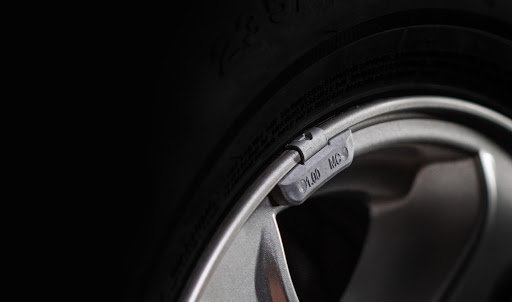

    Which wheel weights are you using for balancing/where do you get them?
    such as for aluminum stock wheels
    I tried some generic steel wheel weights (clip on) but they wouldn't fit the lip. The shape is different.
    At Costco Tire Center they have like 7 color coded baskets based on auto brands for different lip shapes.
    I'm not sure what the Toyota ones are called.

    in my experience both can stay secure if the right shape is chosen,
    and gouging is not always the worst on a truck meant to be beaten up, especially if it's the right shape weight
    unless they're really nice wheels
    but it's harder to use sticky ones on a truck, because big truck tires tend to require lots of weight for balancing.
    like up to 5.00oz in a single spot, whereas cars usually require up to 1oz.
    that's broken up in sticky weights; little ones are 1/4 oz while bigger ones are 1/2 oz
    so it gets difficult to put them all in one spot, needing 10 (a lot) weights.
    whereas if you pick a clip on weight of the right size, it's smaller (but thicker) so it uses less space.
    Unless another way to do that is stack sticky weights atop each other, but that won't work for every truck regarding brake caliper clearance if the wheel is small and a tight fit

    For clip-on wheel weights, FN is the type to use for Tacoma alloy wheels
    https://www.lawsonproducts.com/pdfs/PIRAT_Wheel_Weights_PI.pdf
    Parts stores that are focused more on Garage business may handle them, or purchase through the internet
    if not doing alot of tires suggest purchasing .5, .75, 1, and 2 oz weights.... as you can combine weights ie use (2) .75 oz weights for 1.5oz.....
    just remembering to center the mass of the weight being added on the location indicated by the balancer
    typically I do not worry about .25 oz weights, and have had no problems
