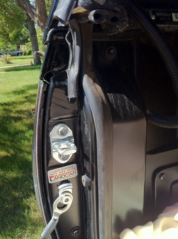

    Yeah, I ran the sides up really high and actually put a 2nd smaller piece in front to sorta reinforce it. Will try to get a pic posted later

    Well, as perfect timing would have it, we had a pretty big steady downpour of rain yesterday for several hours. This is the first time the new TrailSeal kit has been exposed to such elements. It held up pretty well, but I must admit that some water still managed to get in. It was much less than without the seal, but still not perfectly sealed.
    So I might rethink my strategy... but here is a pic showing what I have currently. I cut a small 3-4" piece and stacked it in front of the standard piece that goes all the way from bottom to top. The real issue is that the sides of the bed taper inwards towards the top and create a bigger opening, so it makes it really hard to get a full seal.
