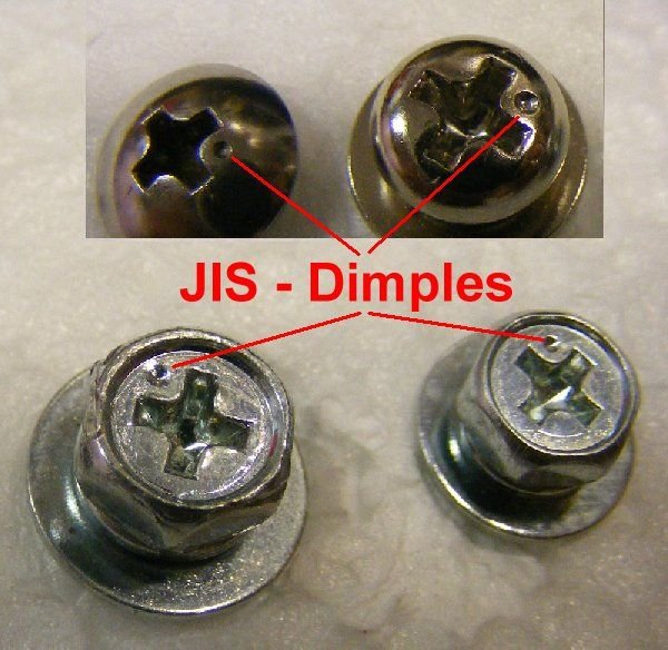

    Phillips driver will easily strip a JIS.
    This is how you id them:
    I'd probably just buy a set of bits.

    I never heard of the JIS dimple on the screw. Do all JIS screws have them? I've never noticed the dimple on motorcycle screws & I've worked on rice burning motorcycles for yrs. All have JIS, & I have messed up several JIS screws with phillips screwdrivers, but a phillips with an impact driver has always worked.
