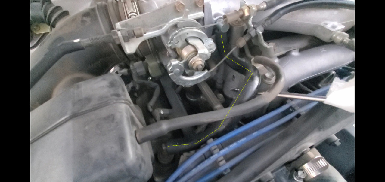

    Which hose is this? I am getting a weird noise (mostly on idle but not always). It seemed to be coming roughly from this area and I noticed it came off SUPER easy and had some dirt/slimy residue on it.

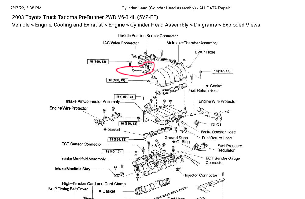

    This diagram doesn't really say much, but it shows the hose in the upper diagram

    thinking its this one (near the throttle body)

    It seems to me that it’s a vacuum line to/from the right hand cylinder head.

    Ive replaced a couple vacuum lines recently (visibly cracked at the ends) but this one is soft (maybe too soft) and if anything too loose. Maybe this one due to heat softened up and when replaced will make the noise go away. I am not getting any codes

    To me it looks like your PCV valve

    my hose was kinda soft, but still rigid. I would recommend a new hose, but at the same time, our definitions of soft can be different. However, if it is craked, you have a vacuum leak, hence the noise, and the residue, which I presume is oil.

    I can squeeze it easily with my fingers and it bends whereas most of the vaccuum hoses Ive replaced and purchased lately have been pretty stiff (old ones REALLY stiff)

    Ah yea. that is pretty soft then. @Wsidr1 is correct, too. Here's a list of pcv locations.
