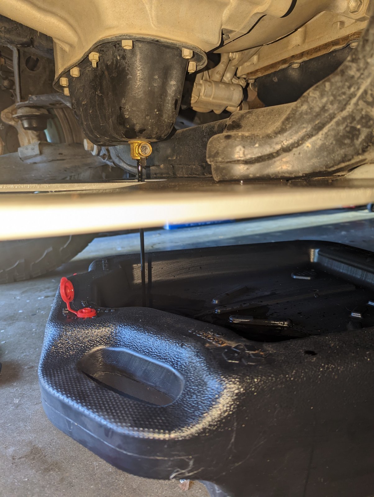

    Here's why I think it pays for itself. The valve gives it perfect no-splatter aim through the skid plate. Hose attachment isn't even needed.

    Correct. The drain tube isn’t “needed” but I use the tube to drain it directly into a jug, the very jug I use to transfer it to a dump station. I also don’t have to clean the pan like the one you are using.

    What skid plate is that on your truck? I have a knock off copy of the TRD skid. Did you have to remove the plate to install it?
    I see you have the one with out the nipple. I'm actually interested in the short nipple or none.
    I had a Fumoto valve on my old Jeep Liberty CRD for over 12 years and never had an issue with it. It was highly recommended for that engine as it had an aluminum oil pan that had potential to be easy to damage. It's a no Brainer for vehicles like that. But I'm on the fence about it on the Tacoma. Having the oil drain in to a neat stream would be idea though.

    I would remove the skid to install it for the opportunity to not dump on the skid even one last time, or clean the top surface. Without a skid, the long nipple can be at risk. With a skid you have bigger problems than the nipple if it is damaged. :eek: Short/long/no nipple is your call in your case.

    I also have the Lostar knockoff TRD skid. I installed the valve with it off (I did it backwards, I bought the valve and then immediately realized it should be covered).:anonymous:
    It should be possible to be able to reach around the skid with a box wrench to install the valve. I reach through the side to open/close the valve when changing oil anyway.
