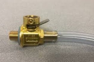

    No way would I go for a quick-disconnect-style oil pan valve of any kind.
    Seen too many QD's fail over the decades in many applications: compressed air lines, water lines, gas torch lines, hydraulic lines, etc. Multiple failure modes: sometimes they jam shut. Sometimes they open & then won't reclose. Sometimes they develop very small leaks.
    The Fumoto plain & simple ball valve is inherently more reliable. No springs or moving parts, and a full-diameter, unobstructed flow path.
    Someone said earlier in this post "Fumotos can have stuck-valve issues." Not sure how that can happen unless thru extraordinary amts of corrosion (?) maybe from lots of winter road-salt exposure. Even that seems unlikely: the body is solid brass, the ball valve is stainless steel, & the seal is some kind of high-performance inert plastic like teflon or viton.
    Surprised no one has mentioned another super handy use for Fumotos:
    Sampling small amounts of oil for periodic oil inspection/analysis/testing.
    I have the Fumoto F133, no nipple sticking out to get snagged or bent, points straight down. Warm or hot 5W-30 motor oil drains out pretty fast, but the stream is thin enough that it doesn't splash in the oil drain catch pan. I'm not servicing a fleet of 50 taxis so I don't care whether it takes 7 minutes or 30 minutes for oil to drain -- I'm not lying there on the garage floor watching it.

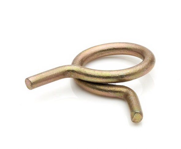

    For off-road use, a Fumoto lever-clip "F-lock" is a must-have addition. Only $2! Too bad Fumoto charges $9.95 for shipping. (I ordered 2, just in case 1 gets lost...)
    Here's a long post I wrote about the F-lock clip, with more photos.
