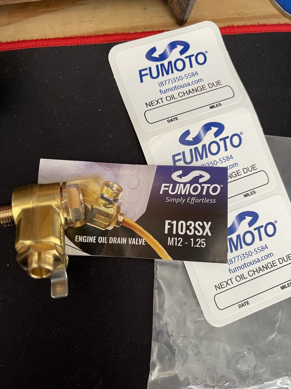

    According to Fumoto’s website theF103SX Works for our trucks, but now that I’ve got mine, which I haven’t installed yet, it doesn’t look like it’s going to work, it seems like the oil is gonna come out sideways? Anybody had any luck with this version?

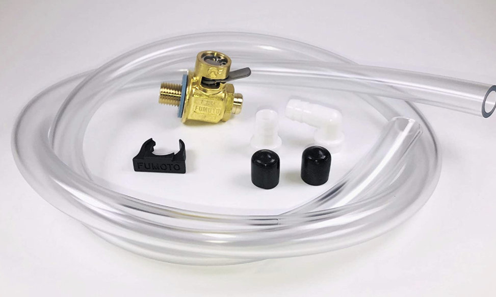

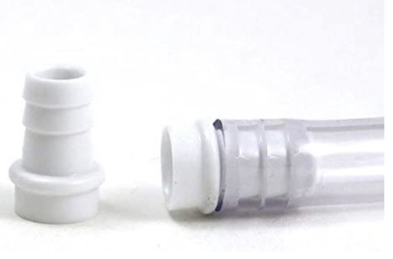

    If you go with the short nipple you also get a plastic adapter that clips onto the Fumoto while the other end accepts the tubing. I used to do this without the adapter and always found it difficult to connect the tubing to the valve. Learn from my mistakes. Easy Peasy.
    I leave the white adapter affixed the the valve and use the black plastic nipple cover on the adapter.

    This configuration makes it more difficult to change the oil if you have skid plates. You want it pointing straight down. Made this mistake too.

    I leave the plastic piece inside the tube, not on the valve.

    I leave mine on mainly because it doesn’t come off easily.
